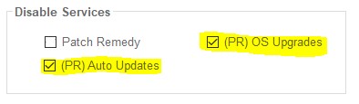

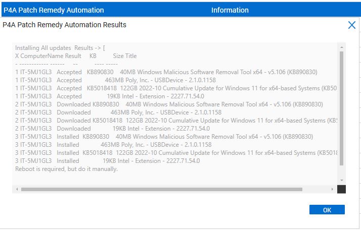

I did not set a schedule in Patch Remedy because we are using CWA patching but left the Patch Remedy check box enabled. My thought behind this was that Patch Remedy might still attempt to fix failed machines. Is this correct or does it not do that anymore? Having some users not getting the traditional reboot message we usually send and this is what I see in the logging:
It appears as though when they released the approvals Patch Remedy took control and did the patching but then didn't run the traditional message. Is that the way it's supposed to be?

If a checkbox is empty for (PR)Auto Updates then the client or agent is set to run updates as needed. Make sure that you check to disable service. The Patch Remedy checkbox is safe to leave unchecked and no updates should happen as a result of Patch Remedy. That checkbox turns off and on patch remedy data collectors.
Can you send me a screen shot of the PR5 client view and the agent view where checkboxes are displayed. Just snap a image and post it here so I can see how your configured.

It was configured with Patch Remedy unchecked, PR OS upgrades checked, and PR Auto Updates checked. I had to disable the Patch Remedy, because our users expect to receive a reboot message after updates. This seemed like unexpected behavior but the auto check boxes are still there, maybe just not working to disable it? Does this program allow us to find and fix failed updating computers anymore? Seems like some of the old functionality and reporting that was in version 4 is missing entirely from this "new" one. Let me know, if it doesn't do that stuff anymore?
Re: Patch Remedy box enabled
That would be correct, is that the agent or client box?

We checked the disabled box for the client and it still performed patch actions against the client outside of the policies set. At this point I've disabled it, doesn't seem to be a good fit for us.

I'm trying out the "P4A Patch Remedy Automation" properties to see if that has any impact on the issue.
