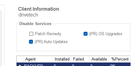

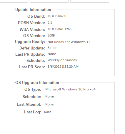

all computers show Last PR update as none, we have the PR auto update checked.
PR Update none.png (19.89 KiB) Viewed 2816 times
PR check boxes.png (9.18 KiB) Viewed 2816 times
Re: Last PR update None
From the image you supplied I see that PR Auto Updates is checked as disabled. PR scans are enabled so you are scanning but not updating.
If you want to turn off a service then check it.
