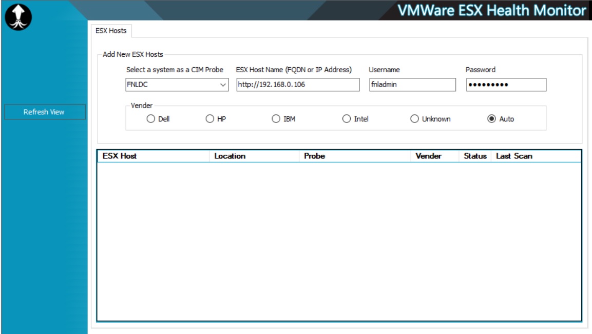

Hello Cubert,
Our plugin has all the previous settings disappeared and it is showing blank information on the plugin tab under the client properties. Also, if I try to add any host information back to it, it wouldn't allow me to do this and the save button is grey out. What could be the reason for this?

Re: Stale alerts
License expired..
If your still have an active subscription then send me a email at support@plugins4automate.com with your email / LThost name so I can go fix your license. We occasionally get a hickup between systems and a licenses does not get updated.
