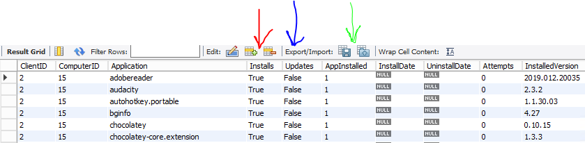

Here is the query to pull updateable software for agentID 650
SELECT Application FROM plugin_p4l_chocolatey_computers Where ComputerID = '650'  and Updates = 'True'  and AppInstalled = '1';
To see if anything shows as available for install or update run SQL query
If this returns 0 then the agent is showing no approved software for install or update.
Our SQL query is testing for these columns to be set to updates = True and Appinstalled = 1 . If you run the second query this should show all approved software for agent ID. does any of this software meet these requirements noted here?

It looks like App Genie is installing some software. The new Firefox updates have been rolled (I think). One thing that I find weird is that the Global console is not showing anything for Adobe Reader (see attached screenshot) but it installed on a whole bunch of my machines. I have attached the results for the SQL query also.
