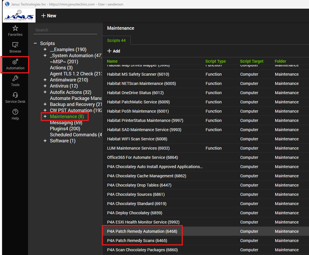

where is this folder located?
Post by Cubert » Wed Apr 17, 2024 12:34 pm
Sounds like your system is getting stuck on the EULA which means its not taking the /accept switch as part of the command being sent to agent. You can review this script and its functions by reviewing the Chocolatey for Automate script in the maintenance script folder.
I believe the script looks for online users and tries to run installer script on a desktop terminal as that user in case a EULA is triggered. But if no user is logged in this can not happen and so I believe EULA is stuck in a non user terminal and can not have its EULA checked as Accepted.

Re: Win 10 to Win 11 failed OS Upgrade
/scripts/maintenance/Patch Remedy *
