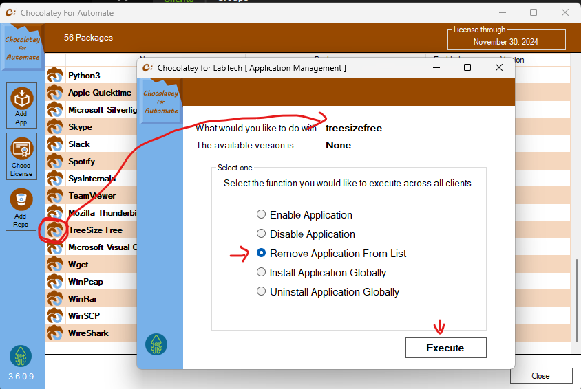

Ok I have two Items.
1. I added a package and it doesn;t appear to be working but is in the list of apps, how do i remove it so i can correect the package with further testing?

#1 Remove App globally from approved apps list.
Click the icon next to package you want to do a function on. A function window will pop up and allow you to remove app from list.
Screenshot 2024-04-19 095741.png (99.74 KiB) Viewed 11188 times
