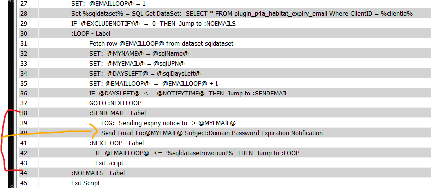

The password Expired emails are sent using a LTscript. This script checks for and loops through all the emails from client data and sends a email using the scripted email command in LT scripts.

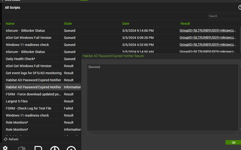

Unless there is a separate place, the script log when it runs just shows "success" from this AM.

Re: emails not being sent from AD notifier
Ok so you are using Habitats AD notifier and not the standalone version... Just so I know where to go look for issues.
Success is given on line 13 after the main read and save of data. next we execute a Powershell script to see if we are between time frame 8am and 3 pm, if so script echos "sendmail" to which we drop into loop to send any email needed.
It looks like your script is not running at 1pm as it should, which would put it between 8am and 3pm which would past test.

You can disable script functions for line 15, 16 , and 17 (right click each line to disable lines in script).
Once these 3 lines are disabled then every time script runs it will test for emails and send 2 emails when a user comes up for notifications instead of one.
At least it should now send a email at 12 am and 1 pm on the day of notice count set in plugin.

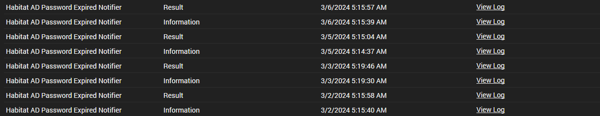

The script only seems to be running around 5 am. I'll try editing those script lines out.

Post by eDot »

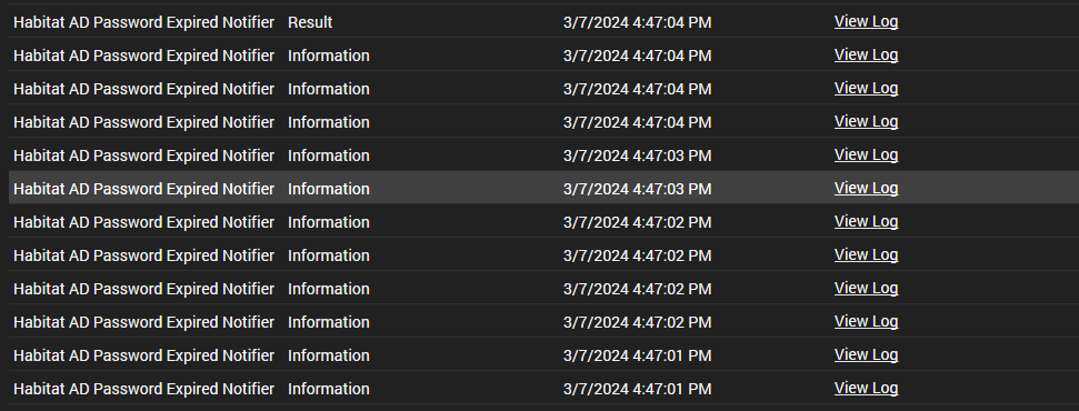

Update. The script just ran on the client except this time. I see all the script log entries for who it sent out which I confirmed shows up in the clients email logs.
So seems like something is throwing off the script timing by 5 hours?
