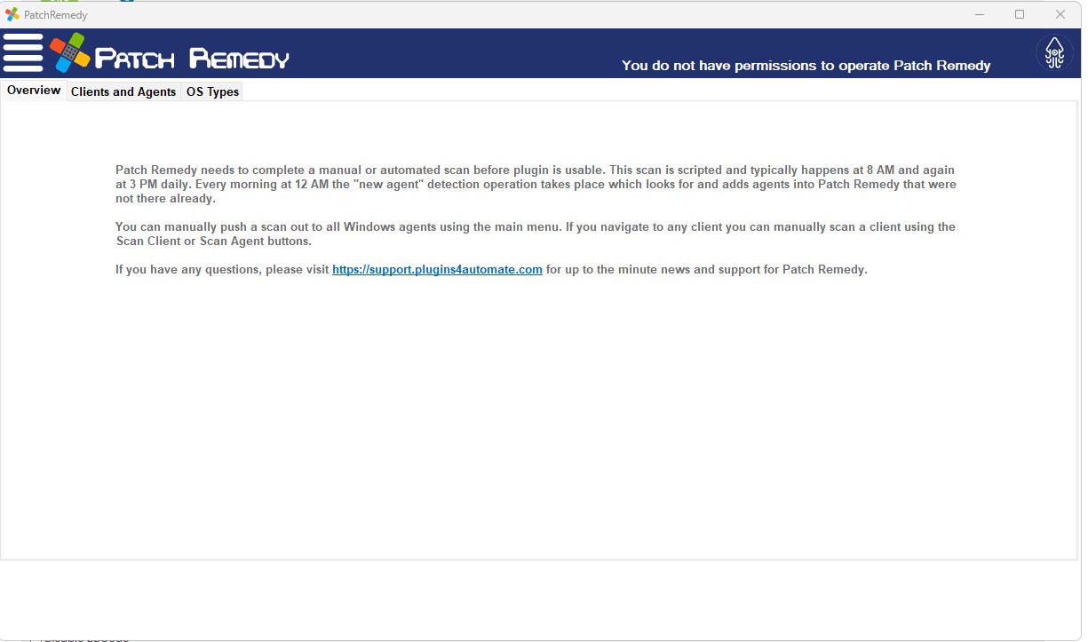

Hopefully I am placing this in the correct place...
We just purchased a new subscription and I installed the plugin as described and have also rebooted the server.
I am a Super Admin and I have also put myslef in the Patch Remdy security group, however, I am still getting the error that I do not have permission to use Patch Remedy.
- Screenshot 2023-08-02 185650.jpg (88.75 KiB) Viewed 18870 times

You will need one of the two user classes applied to the user in question. Log out and back into Control Center to apply any changes to permissions.
Super Admin is a built in default user class and Patch Remedy is an added user class just for Patch Remedy non super user users.. You can have one or the other or both in your class list and it should allow access to your plugin
Can you verify settings with a screenshot?

I figured out what the issue was. Even though I was part of the groups that had access to PR, I was getting the permissions from AD security groups.
As soon as I removed the AD groups from my user and manually put the groups in my user from Automate/Users, i was able to login and see PR as it should be.
Thank you for your reply!
-T
-T
