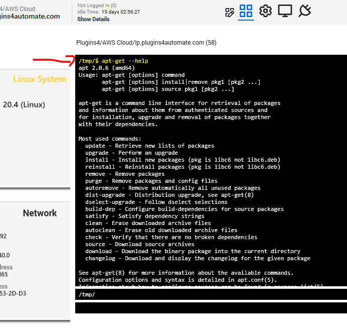

Example here is on a Ubuntu agent so we are using Apt-get instead of Yum.
If you get the help file as expected then does that help file contain the phrase (List of Commands) anywhere inside the text returned?
