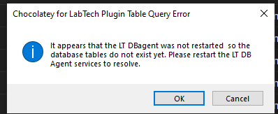

So, from what I understand Chocolatey for Labtech should work with my Automate. Then in that case I have an issue using it. I restarted the server, database agent but when I try to open it I get an error message( see attached file).
How I can fix this ?

You said you rebooted the Automate Server? Or did you restart the Control Center Console? When the Labtech/Automate DBagent is restarted, it is instructed to do the following as seen below. It shows tables to see if table exists, if not it creates them. Make sure a Restart of the DBagent has successfully happened.
This error appears when the following query fails.
SELECT * FROM `plugin_sw_chocolateyii_approved_apps`
To see if table exists
SHOW TABLES LIKE 'plugin_sw_chocolateyii_approved_apps';
To create the table we execute in SQL
CREATE TABLE `plugin_sw_chocolateyii_approved_apps` (  `id` int(11) NOT NULL AUTO_INCREMENT,  `Application` varchar(245) NOT NULL,  `AppCMD` varchar(245) DEFAULT NULL,  `Image` mediumblob,  `Source` varchar(255) DEFAULT NULL,  `SourceName` varchar(255) DEFAULT NULL,  `SourceUser` varchar(64) DEFAULT NULL,  `SourcePass` varchar(145) DEFAULT NULL, `AsAdmin` INT(2) NOT NULL DEFAULT 0,  PRIMARY KEY (`id`)) ENGINE=InnoDB AUTO_INCREMENT=35 DEFAULT CHARSET=utf8;
If table exists try adding an approved application to apps list. See if that works or fails.
Post back your findings here.
If you are hosted then you will need to download a SQL access tool or request from support to validate the table listed above.

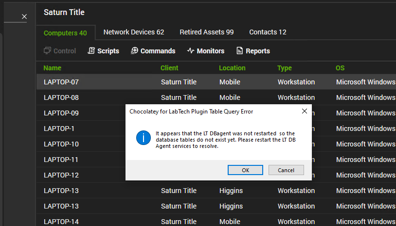

Hello,
This error only shows up when I open the main console or try to refresh it:
main view.PNG (84.87 KiB) Viewed 30294 times

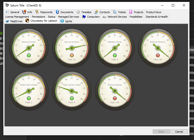

In the client window there is no reaction :
client console.PNG (329.34 KiB) Viewed 30294 times

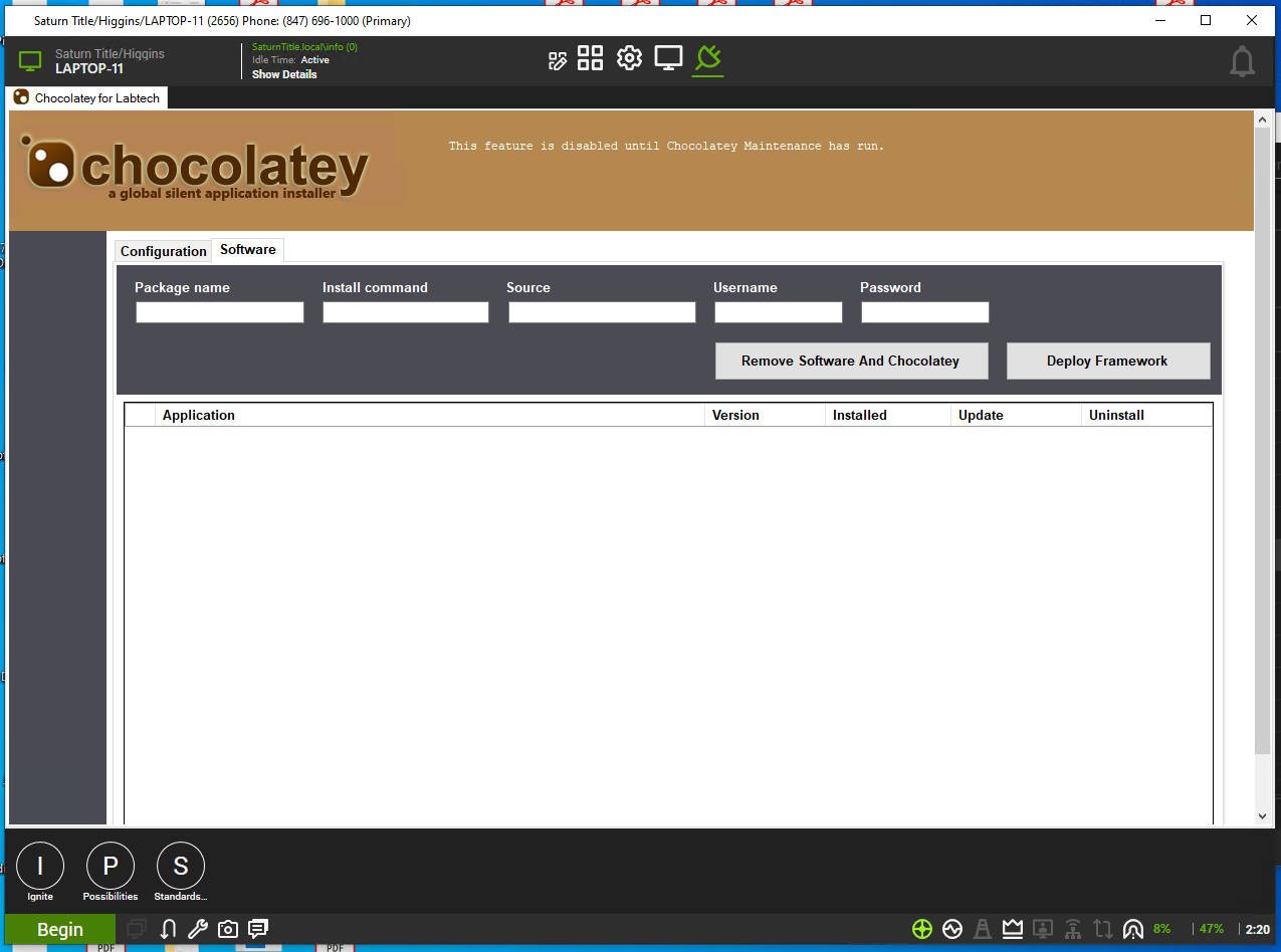

In agent console it's just empty :
agent console.PNG (114.15 KiB) Viewed 30294 times

When you say
You are referring to going to the Tools Menu and launching the Chocolatey Global Management tool. I want to make sure we are on the same page.
The agent page would be accurate if Agent has not deployed Chocolatey yet.
The client page looks to not be loading at all. Those are not our gauges. So you may also be having an issue there as well.
