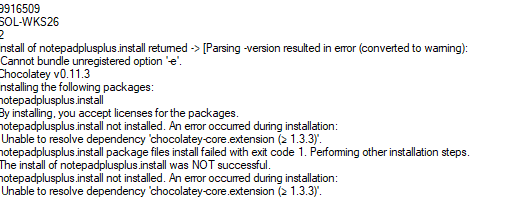

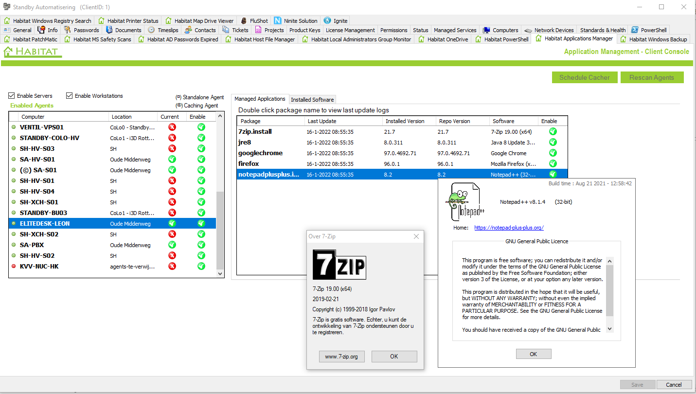

In my struggle to get the application manager running after installing the plugin, I now also face the issue that the reported installed version is incorrect.
At least notepadplusplus and 7zip ar not correct, please see screenshot.
does anyone know why this is happening, and what is wrong?

Extra info, looks like it has something to do with parsing the version number?

Here is a perfect example of the core.extensions being needed. You need to make sure this is included in your location drive cache. Add it to the search in the global config for the plugin.
You should add to your search the following...
See the bottom post, adding a dependency, Add that exact dependency
viewtopic.php?p=8970#p8970
