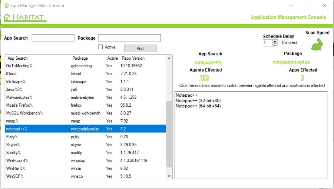

Repo version os now in place, however when trying to install an app to a synced system the script returns ok but the application is not installed (notepadplusplus).
I will continue in the other ticket if you plefer, the one that has more history,.
Although I think I now understand how the app manager works, It doesn't seem to work as it should..

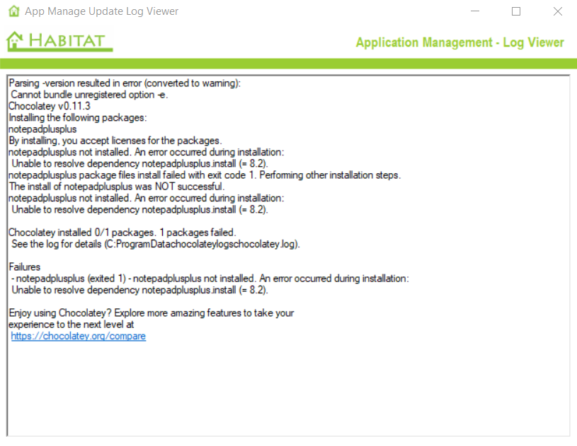

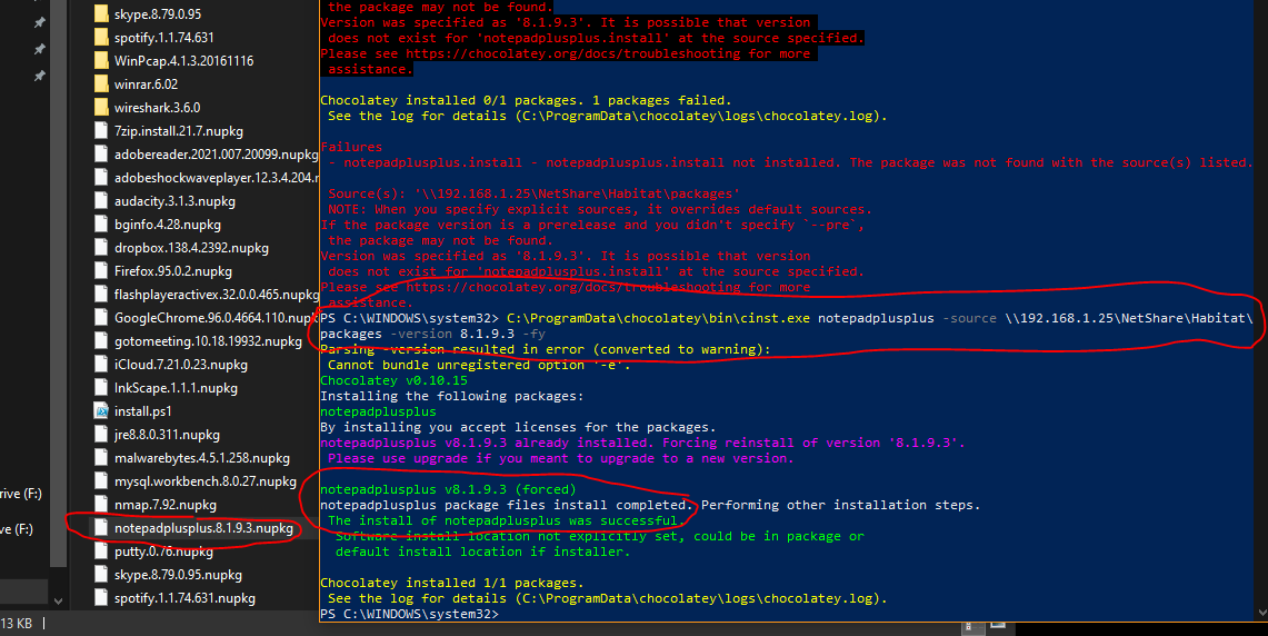

The app is in the list yes, Notepad++ is pretty common app right?
Please see log below, and screenshots attached:
2022-01-10 18:13:16,424 23576 [INFO ] - ============================================================
2022-01-10 18:13:16,738 23576 [WARN ] - Parsing -version resulted in error (converted to warning):
Cannot bundle unregistered option '-e'.
2022-01-10 18:13:16,777 23576 [INFO ] - Chocolatey v0.11.3

2022-01-10 18:13:16,956 23576 [DEBUG] - _ Chocolatey:ChocolateyInstallCommand - Normal Run Mode _
2022-01-10 18:13:16,961 23576 [INFO ] - Installing the following packages:
2022-01-10 18:13:16,963 23576 [INFO ] - notepadplusplus
2022-01-10 18:13:16,964 23576 [INFO ] - By installing, you accept licenses for the packages.
2022-01-10 18:13:17,147 23576 [INFO ] - [NuGet] Attempting to resolve dependency 'notepadplusplus.install (= 8.2)'.
2022-01-10 18:13:17,161 23576 [ERROR] - notepadplusplus not installed. An error occurred during installation:
Unable to resolve dependency 'notepadplusplus.install (= 8.2)'.
2022-01-10 18:13:17,168 23576 [INFO ] - notepadplusplus package files install failed with exit code 1. Performing other installation steps.
2022-01-10 18:13:17,173 23576 [DEBUG] - No package information as package is null.
2022-01-10 18:13:17,178 23576 [DEBUG] - Attempting to create directory "C:\ProgramData\chocolatey\.chocolatey".
2022-01-10 18:13:17,189 23576 [DEBUG] - Adding 'Hidden' attribute(s) to 'C:\ProgramData\chocolatey\.chocolatey'.
2022-01-10 18:13:17,194 23576 [DEBUG] - No package information to save as package is null.
2022-01-10 18:13:17,196 23576 [DEBUG] - Sending message 'HandlePackageResultCompletedMessage' out if there are subscribers...
2022-01-10 18:13:17,198 23576 [ERROR] - The install of notepadplusplus was NOT successful.
2022-01-10 18:13:17,200 23576 [ERROR] - notepadplusplus not installed. An error occurred during installation:
2022-01-10 18:13:17,202 23576 [DEBUG] - Attempting to create directory "C:\ProgramData\chocolatey\lib-bad".
2022-01-10 18:13:17,211 23576 [WARN ] -
Chocolatey installed 0/1 packages. 1 packages failed.
See the log for details (C:\ProgramData\chocolatey\logs\chocolatey.log).
2022-01-10 18:13:17,213 23576 [INFO ] -
2022-01-10 18:13:17,214 23576 [ERROR] - Failures
2022-01-10 18:13:17,216 23576 [ERROR] - - notepadplusplus (exited 1) - notepadplusplus not installed. An error occurred during installation:

2022-01-10 18:13:21,937 7392 [DEBUG] - Received arguments: list notepadplusplus --exact
2022-01-10 18:13:21,979 7392 [DEBUG] - RemovePendingPackagesTask is now ready and waiting for PreRunMessage.
2022-01-10 18:13:21,989 7392 [DEBUG] - Sending message 'PreRunMessage' out if there are subscribers...
2022-01-10 18:13:21,996 7392 [DEBUG] - [Pending] Removing all pending packages that should not be considered installed...
2022-01-10 18:13:22,043 7392 [DEBUG] - Performing validation checks.
2022-01-10 18:13:22,048 7392 [DEBUG] - Global Configuration Validation Checks:

2022-01-10 18:13:22,626 7392 [INFO ] - notepadplusplus 8.2 [Approved]
2022-01-10 18:13:22,636 7392 [DEBUG] - --- End of List ---
2022-01-10 18:13:22,647 7392 [WARN ] - 1 packages found.
2022-01-10 18:13:16,784 23576 [DEBUG] - Chocolatey is running on Windows v 10.0.20348.0
2022-01-10 18:13:16,787 23576 [DEBUG] - Attempting to delete file "C:/ProgramData/chocolatey/choco.exe.old".
2022-01-10 18:13:16,790 23576 [DEBUG] - Attempting to delete file "C:\ProgramData\chocolatey\choco.exe.old".
2022-01-10 18:13:16,801 23576 [DEBUG] - Command line: "C:\ProgramData\chocolatey\choco.exe" install notepadplusplus -source C:\Windows\LTSvc\Habitat\packages\ -version 8.2 -fy
2022-01-10 18:13:16,803 23576 [DEBUG] - Received arguments: install notepadplusplus -source C:\Windows\LTSvc\Habitat\packages\ -version 8.2 -fy

2022-01-10 18:13:16,945 23576 [DEBUG] - The source 'C:\Windows\LTSvc\Habitat\packages\' evaluated to a 'normal' source type
2022-01-10 18:13:16,947 23576 [DEBUG] -
NOTE: Hiding sensitive configuration data! Please double and triple
check to be sure no sensitive data is shown, especially if copying
output to a gist for review.
2022-01-10 18:13:16,954 23576 [DEBUG] - Configuration: CommandName='install'|CacheLocation='C:\Windows\TEMP\chocolatey'|
ContainsLegacyPackageInstalls='True'|
CommandExecutionTimeoutSeconds='2700'|WebRequestTimeoutSeconds='30'|
Sources='C:\Windows\LTSvc\Habitat\packages\'|SourceType='normal'|
Debug='False'|Verbose='False'|Trace='False'|Force='True'|Noop='False'|
HelpRequested='False'|UnsuccessfulParsing='False'|RegularOutput='True'|
QuietOutput='False'|PromptForConfirmation='False'|AcceptLicense='True'|
AllowUnofficialBuild='False'|Input='notepadplusplus'|Version='8.2'|

Re: Newly 3rd party application manager not working correctly
I think I see your issue?
Can you verify what versions of Notepadplusplus you have in you local cache repo.
I tested your command line and I failed as well, Passing 8.2 as a version. After looking at my repo I only show 8.19.3 as the version, passed that and all worked for me. I to show a repo version of 8.2 but my repo has no such version. I cleared my repo and reran repo update and I got the same version of NotePadPlusPlus (8.19.3) so that is what Chocolatey is issuing.
Very Bizarre.
I made a adjustment to my command and it was successful.
Here you can see I looked into my local repo and then called it direct from the local cache.
I'm going to poke around with this some more to see why Chocolatey said on thing to our master versioning service but only hands out a previous version.
Very Bizarre.
It says version 8.2 in the rapo, and also on the sitecache
If on the agent in question,
Do you receive same error?
C:\ProgramData\chocolatey\bin\cinst.exe notepadplusplus -source [b]YourLocationDriveHere[/b]\Habitat\packages\ -version 8.2 -fy
