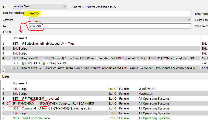

Posted: Mon Dec 13, 2021 6:52 pm
the MYCMD variable is used by Habitat to control what parts of the script get run. Its a means to select functions out of the script instead of running each and every line.
So if MYCMD = UPGRADE then it run the entire Then statement section. If MYCMD = anything else it goes to the else section where we test it further to see if it equals a given command value. In this case we are looking for SCAN, if it is set as MYCMD then we will seek out the scan function in the else statement and execute till the next exit script function.
This allows us to have 1 script but many functions we can call.
You do not need debug, what you need is to view the script and command output logs in the agent console for the time stamps that the script is running. The script should log some data and the executing commands on agent will log the commands return so you can see the raw output from any command execution.

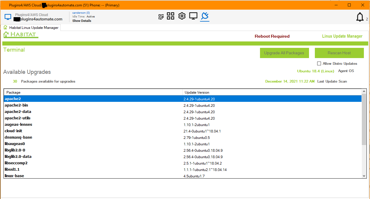

Actually do not bother, I believe I found the issue.
It appears that ConnectWise may have updated the Shell and other script commands functions where now we get execution of a shell but no returns. So if you run in enhanced shell cat /etc/hosts it will no longer return the file output but now just returns "OK" .
So when we try to test to see if execution produced the correct file we get "OK" instead.
I have corrected this in the next build due out ASAP (next 24 to 48hr.) Should be Habitat build 1.0.1.14. We also tweaked the UI a little bit to make it a bit nicer. Here is a sample of the new layout and working collections.

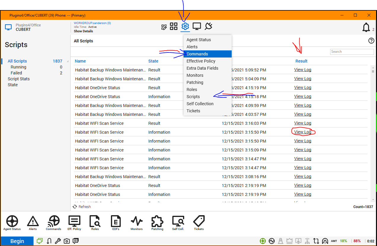

Posted: Wed Dec 15, 2021 10:53 pm
This is the agent console and you should select the gear and then select either commands or scripts to see the logs for either. This is the heart of how to see and troubleshoot automation tasks.

by frankbe
ok, thank you - i know this place but log is only
No results were returned, exiting script-> [OK]
I thought there's a more detailed log
