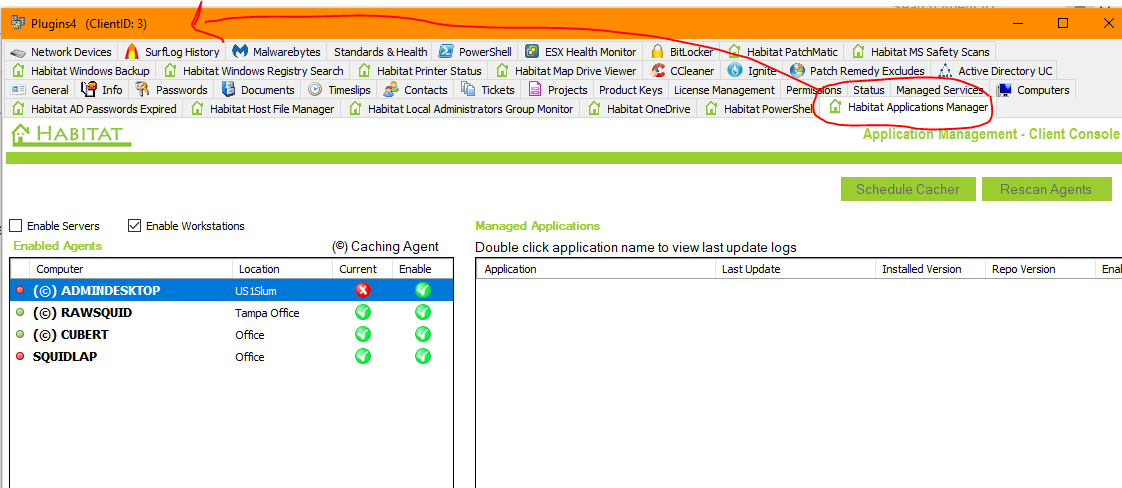

Oh maybe your talking
3rd Party Publishers?
You want the 3rd party Application update manager, yes?
Its now Habitat Applications Manager and there is a client Tab for it.

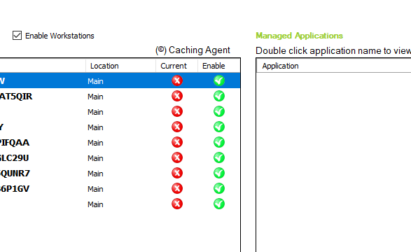

habitat 0.png (33.02 KiB) Viewed 14945 times
I don't have caching enabled but I assume thats not needed anyhow since these guys don't have common storage onprem.

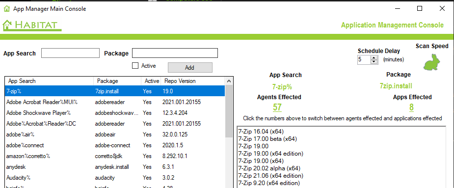

habitat 1.png (22.46 KiB) Viewed 14945 times

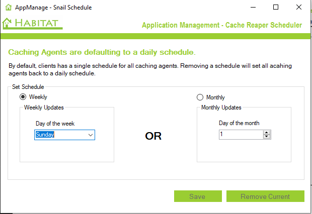

I don't seem to be able to get things on a daily schedule (for testing). the remove button doesn't do anything.
habitat 2.png (17.21 KiB) Viewed 14945 times

Second Issue
"I don't seem to be able to get things on a daily schedule (for testing). the remove button doesn't do anything."

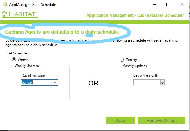

This tells you what is currently set, as you select and change dates or use the remove button, this text should change telling you if you are set to weekly or monthly else the default is daily as stated. The remove Setting changes this text back to the Daily is the Default text and sets the system back to daily. Otherwise the text will say monthly or weekly based on what you save.
You are not the first to be a bit confused by this. I will look at this and see if we can change the behavior so it is more apparent which of the 3 settings is currently active.
Inkedhabitat 2_LI.jpg (898.29 KiB) Viewed 14934 times

For the schedule, I see now..if I hit save then I would have had a weekly schedule but since the buttons were greyed out, it was a daily schedule.
