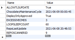

We have added in a new control variable to assist in setting the Excessive Running Commands test when running automation to do framework installs, App installs and App update. To view the properties for C4A run the following SQL
SELECT * FROM plugin_p4l_chocolatey_properties;
Should Produce the following:
The setting is called EXCESSIVECMDS with a default value of 3. To adjust value run the following SQL command
REPLACE INTO plugin_p4l_chocolatey_properties(`Name`,`Value`) Values('EXCESSIVECMDS','5');
This will set the EXCESSIVECMDS value to 5. You can set it any where from 0 to 99 but 99 would be really excessive!
