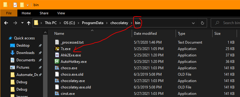

I will be happy to put in a test like this, might need to link it to a on / off switch so you can chooses whether or not it removes directory. There could be things in that directory that may be blown away that shouldn't be. Like in the BIN directory it likes to store portable apps.
See image, 7Zip is there along with several others I have on my install list. By blowing away this root directory the end user will loose those files as well. So adding a control that will toggle this feature on and off would be in the interest of the MSP.

That's a pain then. If choco.exe goes walkabout, the Chocolatey script won't fix it and none of the apps will ever update!
Are you *sure* that's where portable apps go? I've not got any portable apps but I do have 7zip in there but 7zip itself is installed in C:\Program Files\7-Zip.
<Later> Looks like they are shims
https://docs.chocolatey.org/en-us/features/shim
Posts: 2724
9
Re: Framework not installing
Doh, I knew about shims.. just didn't connect when I went looking into deleting cause and effect would be. You absolutely correct, these are just simlinks placed here to keep from adding a bunch of installs to the $PATH variable. That maybe a effect that some of these apps may loose the ability to be called from command line indirectly. Not that's a big game changer but may cause other scripts and such that you created that call (7zip.exe instead of C:\someSubsetOfDirectories\7zip.exe) to suddenly fail until Choco is reinstalled and managing apps again.

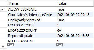

We have added in a new control variable to assist in setting the Excessive Running Commands test when running automation to do framework installs, App installs and App update. To view the properties for C4A run the following SQL
SELECT * FROM plugin_p4l_chocolatey_properties;
Should Produce the following:
The setting is called EXCESSIVECMDS with a default value of 3. To adjust value run the following SQL command
REPLACE INTO plugin_p4l_chocolatey_properties(`Name`,`Value`) Values('EXCESSIVECMDS','5');
This will set the EXCESSIVECMDS value to 5. You can set it any where from 0 to 99 but 99 would be really excessive!
