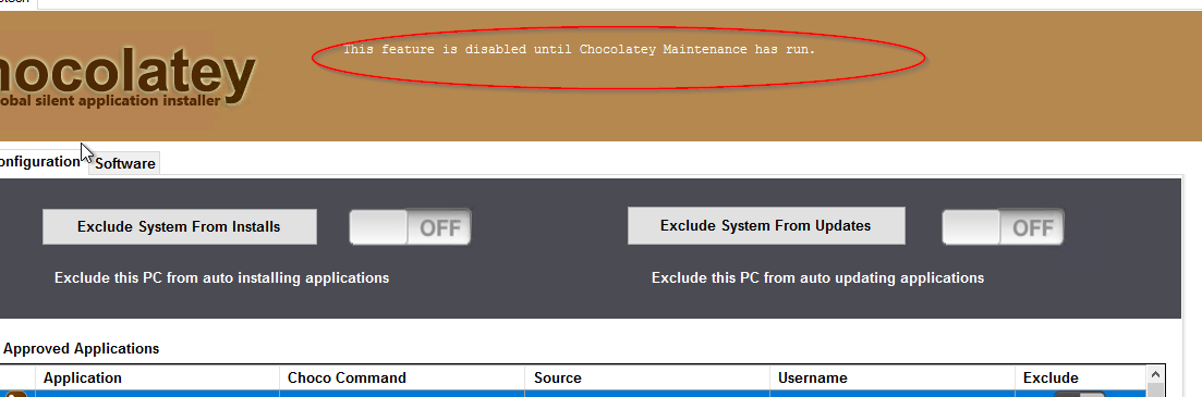

when adding computer to choclatey we always see the message: This feature is disabled until chocolatey maintenace has run.
We reduced the maintenance to run every hour, but it´s still teh same.
How can we fix this?
Disabled until Maintenance has run
- 2021-05-18 10_07_39-Window.png (47.43 KiB) Viewed 12822 times

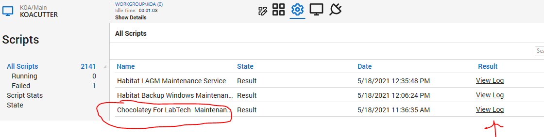

Either the agent was disabled somewhere in the chain of the plugin (global, client, location or agent) or agent offline during every maintenance run (unlikely) or Maintenance is failing / not scheduling.
So the first thing we want to look at is the script logs for the agent.
This will tell you if it is failing or succeeding and what messages were returned with the result.
The bigger question is why is the framework not installing for you.

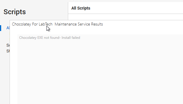

Re: Disabled until Maintenance has run
I get:
Chocolatey EXE not found- Install failed

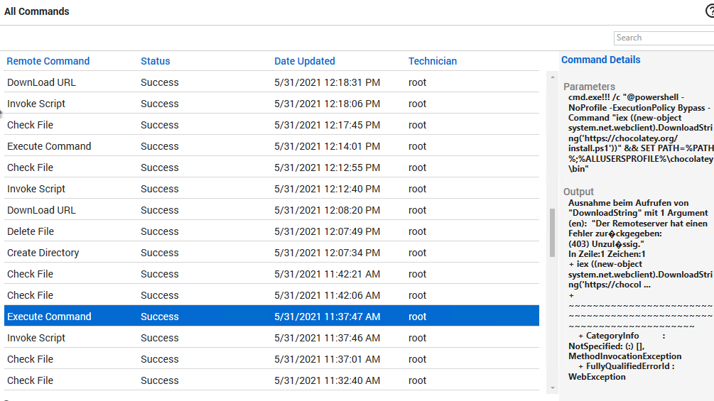

That´s what I see in commands:
- 2021-05-31 23_48_57-integrate-it - ASG-RemoteDesktop 2019.png (78.88 KiB) Viewed 12452 times
