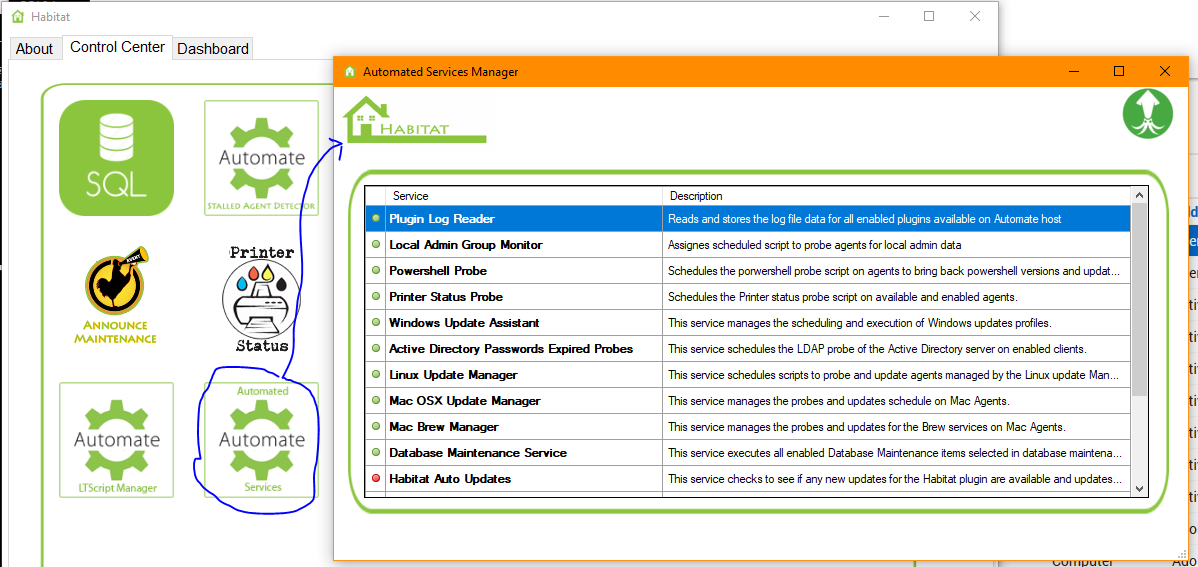

You can turn off the automation for those services inside the Automated Services tool.
Select the services you wish to stop and disable them.
Create the group needed to manage the maintenance scans and set it up as desired to run at least once a day but twice will keep data and alerts more current.

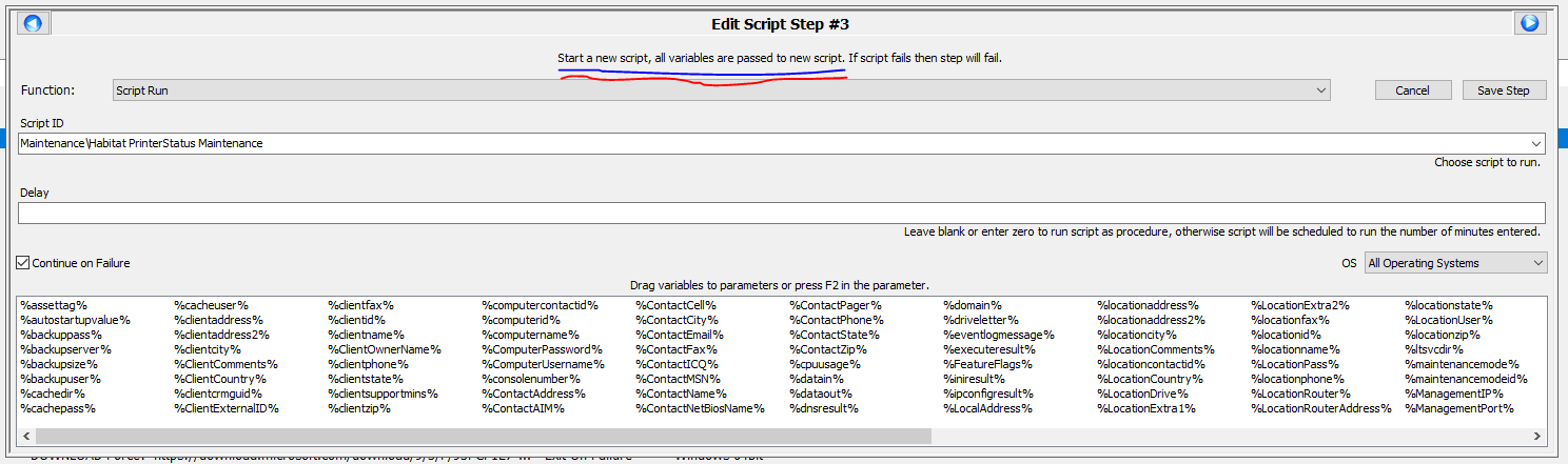

Next create a new script and call it Habitat Maintenance Runner or something like that to identify that this script will be the proxy to Habitat Maintenance and service scan functions.

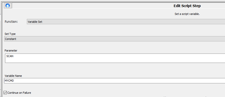

You want to first set the variable needed for script function you are calling.
Then call the script with a script run command. It should pass the variable to Habitat script and it will go off and do it's thing.
Now configure your group to execute the new Proxy script which can run several maintenance tasks before exiting.

You can find what variables you need to set by viewing the Habitat scripts in question to see what variables are allowed and if multiple variables are needed.
