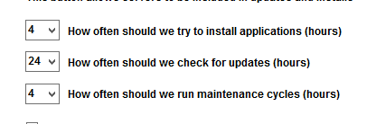

, I have installed the Chocolatey for Automate plugin and I’m having a bit of an issue. I enabled the agents and I selected packages and attempted to have it install them on the machines.
It does not install the programs on the machines.

The cycles timing is set in the global plugin manager
If you have the following setup, it will take up to 4 hours to do first maintenance, another 4 hours to do versioning after first maintenance ran and then another 4 hours after that to install software.
So in this configuration, you should expect a minimum of 16 hours to get the first apps installed. If agent is offline during any of this time you can expect delays until each step has fully completed.
