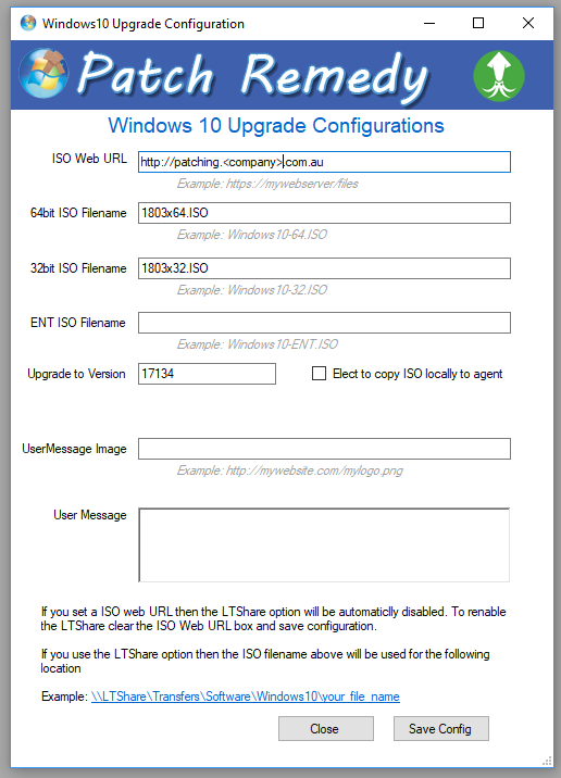

Thanks Cubert.
I've attached a screenclip of the config page. I've also confirmed that http://patching.<company>.com.au/1803x64.iso works when keyed into a browser.
Once I'm back onsite tomorrow I'll edit the permissions for the share, however I recall setting it to "everyone" which I figured should have covered it
Will confirm when I can!
- labtecherror.PNG (49.89 KiB) Viewed 10941 times
Re: Unable to download and also create directories
That looks accurate so no issues there.

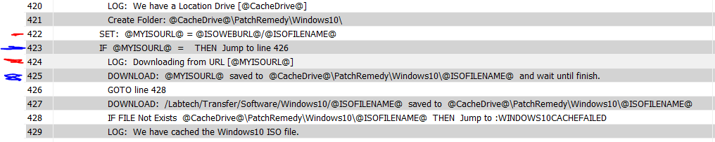

Next we are work a know bug where the Download command on line 425 when placing variables like so (@url@/@file@) that Labtech script saves it as (@URL@\@FILE@) which places the slash backwards. This then causes the download to fail.
So we are looking to post a work around for the latest LT 12 users for whom experience this bug. We are now testing the following updates to the "Then" section of our Patch Remedy script. See the image below. We -that and create a new variable from the 2 variables that make up the URL and file location for the URI. Next we test it to see if it is blank, then we log it to the script log so during execution you can see exactly what is being called then we download it.
Red lines = newly added lines to script
Blue lines = edited existing lines in script
So make your script look like the above script clip and see if that changes your results.
