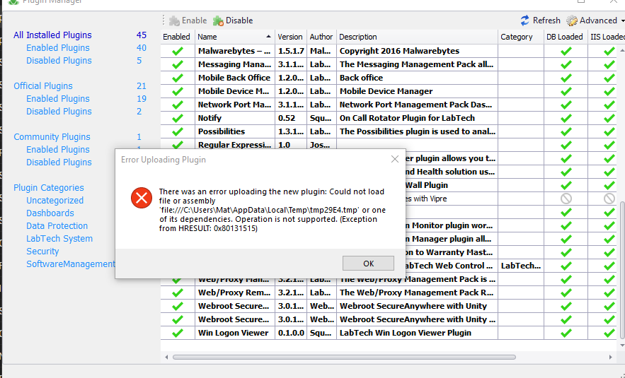

When trying to install the DLL file i'm getting the error in the attached screenshot:
Error Uploading Plugin
There was an error uploading the new plugin: Could not load file or assembly 'file:///C:\Users\Mat\AppData\Local\Temp\tmp29E4.tmp' or one of its dependencies. Operation is not supported. (Exception from HRESULT: 0x80131515)
OK
2018-02-22 18_22_30-Plugin Manager.png (55.73 KiB) Viewed 9635 times

For reference: version 1.0.3.92 on Labtech 12

I was able to do this directly on my labtech server. so ignore this if you like!
Posts: 2724
9
Re: Issue installing PR
You have a locked DLL file.
See how to install plugins help file at https://www.plugins4labtech.com/pages/h ... to-labtech
This will show you how to unlock the DLL and then install. Make sure to close and relaunch the LT control center before attempting a install.
