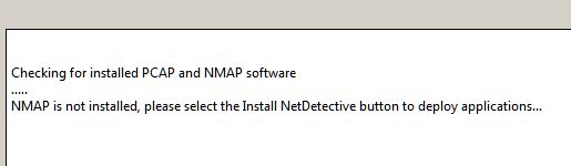

Hmmm, maybe a 32 bit / 64 bit issue.
Need to look at code to see if we are looking in (x86) only if we see that available.
I will get back to you soon.
Re: NMAP Installation Issue
Posted: Fri May 12, 2017 1:22 pm

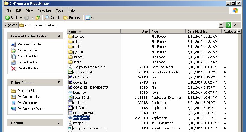

Ok looking at code we test both places.
First CMD is
if exist ""C:\Program Files (x86)\Nmap\nmap.exe"" echo Nmap Installed
Then if that does not return Nmap Installed we run this CMD
if exist ""C:\Program Files\Nmap\nmap.exe"" echo Nmap Installed
You would think you are not returning NMap Installed on the second CMD. I can see you looked at the CMD tab and see that return was correct? So why did it fail the test?
Posted: Fri May 12, 2017 1:27 pm
Doh!
Bloody Hell!! I found the problem... I never "refreshed" my output variable with the second test data. I carried over the test 1 data to test 2 so it never matches up. Give me 1 minute to release a new build.
