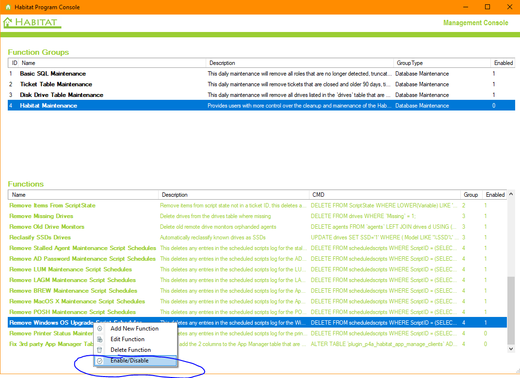

Yea, That's a bug,
It should enable and disable individually as well as a group. Looks like the enable is working but disable may have syntax issue causing it not to save and thus you never see it flip to disabled.
I'll look in to that.
Posted: Wed Dec 15, 2021 4:10 pm
Yeap, found it.
Look like it works fine here
But only enables here and not disables when selected.
This is just a minor logic issue in the viewer, ill get corrected.

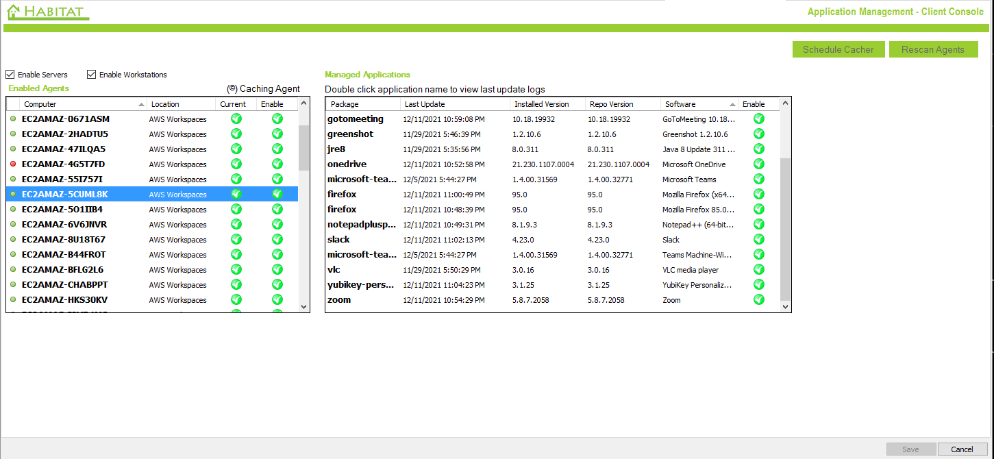

Is there any way to make the Managed Applications Window use a percentage of the remaining width or height?
It would be helpful to see more of the Software name, or even possibly more rows if that's an option as well.
Either way, thank you for adding the software column. That's a big help in certain situations.
Habitat managed applications window.PNG (75.4 KiB) Viewed 12307 times

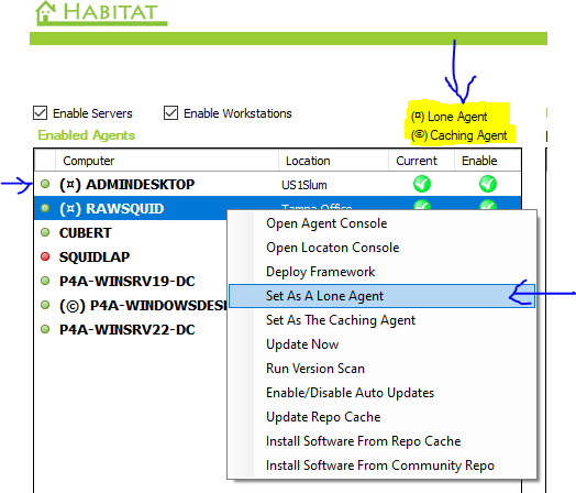

Sorry for the delay, I have been doing a little clean up and testing here to see if we have any issues. I am also working on the remote agent issue where agent has no access to caching.
In build 1.0.1.15 I have added a new function called LoneWolf which identifies agents that are going to skip the caching process and instead attempt updates directly with Chocolatey. You will assign this status in the same way you assign a caching agent.
I am also taking this time to review the different functions on a clean database to see if we have any startup issues with new clients.
I did find that one of my caching agents was having an issue with completing Caching Updates. Kept getting stuck on last POSH call. When I changed caching agents to a new agent, the problem stopped and that agent was able to complete all caching downloads and copies as expected.
I believe that was a one off agent issue and not an issue with the scripting, but it does go to say you should never expect Automate "not" to toss in a few curve balls of it's own from time to time.
I do not expect to have 1.0.1.15 out until after the new year. Jan 5th is most likely the closes date of release. If there is some level of collection issues then we will have identified it and fixed it by then.
New Lone Agent function.
Set any agent as a lone agent will cause that agent to install direct from Chocolatey. Beware of possible limiting from Chocolatey if max connections are reached by location router addresses.

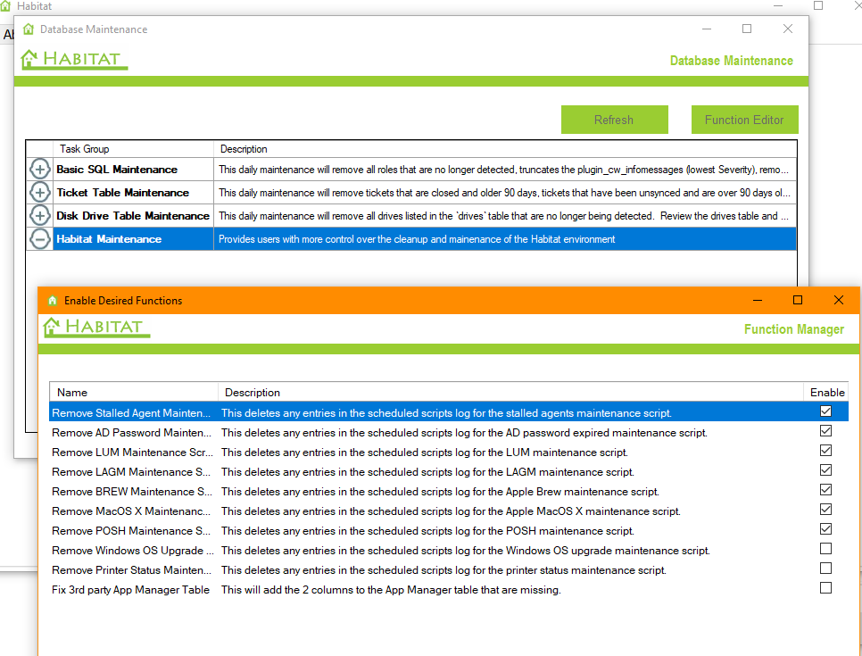

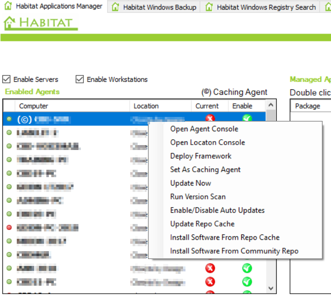

Nice find on the flush bug. Some one set the button to Yes/No then preceded to wait for the "OK". Well just like there's no "I" in Team, there is also no OK answer in a yes or no question.
Next I agree on the standalone agent rename, done...
As for the current indicator. Actually that does not denote that framework is installed although it will never turn green unless the framework was installed. So so happens that framework install is the first of several tasks that take place before an agent starts reporting.
This green current status is based off the last update scan date, as long as that date is under 30 days the agent update checks should be "current". It does not mean that applications are all at the most reported level or that any given app has had updates. Only that the agent has had a version scan preformed successfully in the last 30 days. Why 30 days? Because that is the max time you can set Habitat to manage applications. Once a month is the slowest you can have the application servers run. Typically MSPs are daily or weekly so the green status should stay present but agent that show a red have been offline during any scan requests and after 30 days will show as red in the plugin if scans do not run. You can manually run scans and if successful will trigger a green status.

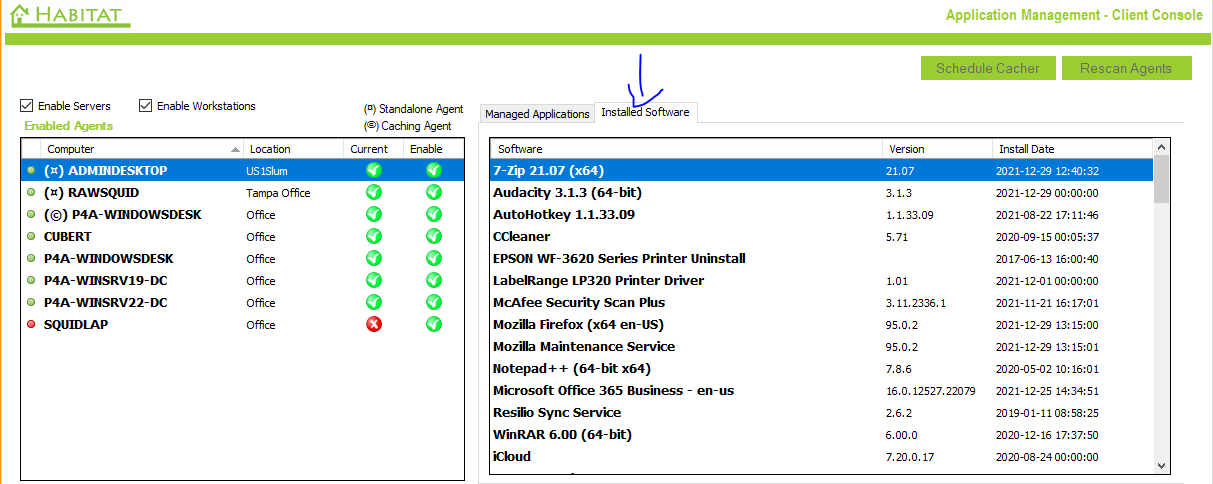

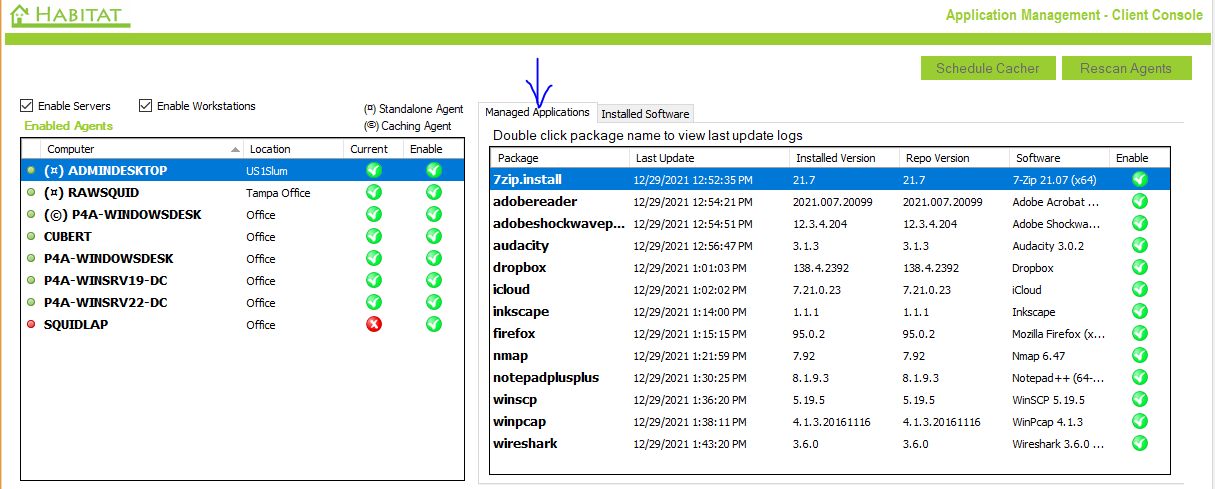

Lastly, I found that having quick access to the installed software list as reported to Automate in the plugin along with the Applications being managed makes it much easier to see if applications are matching up. So I have added a tab view for the split of managed applications to installed software for each agent.
The Managed Apps List
Installed Software list
And from the view here looks like the Standalone deployments and updates launched yesterday as expected, That's a go..

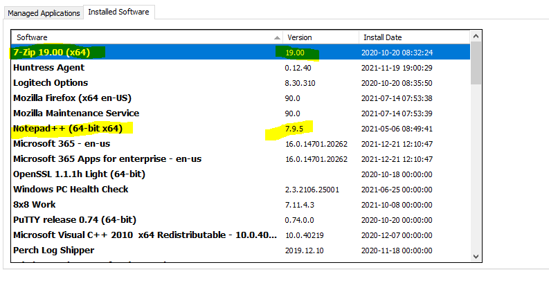

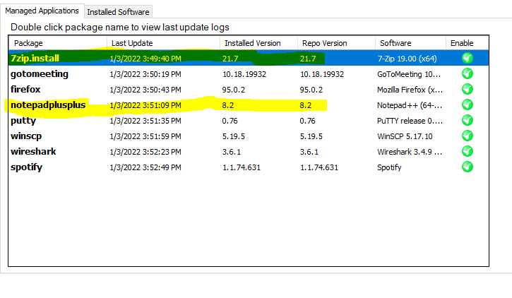

Hello, just getting setup using the 3rd Party Application Management and I am seeing an issue in my deployment where on all my agents (one client at this point) the Installed Version is the same as the Repo Version, even though when I check the new Installed Software tab (updated to 1.0.1.15) it shows an older version than the repo, as well as when I check the acutal application version on that machine. See the below screenshots.
