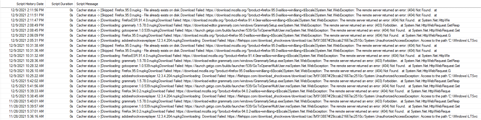

There are issues downloading some package files. Part of this may be just an issue with bad packages, but I wanted to run this by you just in case. This issue deals with specifying variables in the download source link that is not valid. For example, the issue with Firefox is that it includes the "locale" variable at the end of the download line, which is not valid.
Download Failed: https://download.mozilla.org/?product=f ... g=${locale}
If I remove the "&lang=${locale}" at the end of the line, it works. It seems like it might be a Firefox package or site issue, but if that is related to the parsing from Habitat in any way I wanted to bring it up.
Here is a list of various package download issues I am seeing, which may be issues with those packages or possibly with Habitat.

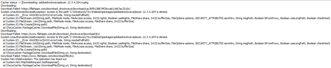

To be more specific, on the caching Agent/Server every application triggers a "Checking repo cache for [application_name]"
On every package, it always triggers the following error every time it goes through a repo cycle.
"Cacher status -> [Directory 'C:\Windows\LTSvc\Habitat\packages' does not exist.]"
That is not the repo cache directory, so it doesn't make sense why it's checking the default LT Habitat location for a packages directory as that is not the configured Habitat packages directory. The configured packages directory as specified at the LT site level is where the packages directory exists.

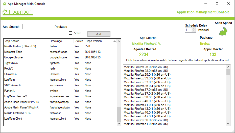

Would it be possible for a repository rescan button on the Application management main console instead of waiting overnight for that particular script of Habitat to kick off. I say this because if I'm troubleshooting something and I change the list of global applications, the repository field will say none until 5AM. This can be problematic if I'm troubleshooting something. I'd like to be able to press a button that allows the global application list to rescan the Chocolatey repository and record the version information. I'd also like to see a reset button that clears all the values to none so I can then press a rescan button to recheck all the versions, which can wipe out any legacy applications that no longer have valid repository information in Chocolatey. This would be helpful when troubleshooting applications and removing stale applications that are legacy or if there is any problem with the list. For example, this screenshot shows applications I was troubleshooting, but I have to wait overnight to see if the version populates, confirming it is working.

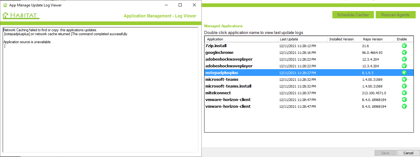

In some situations, the installed version column is still not showing up, and there is an error stating, "Application source is unavailable". These systems pass all the script checks, and some systems in the same site are showing up correctly. See the screenshot below to so you can see what I mean.
