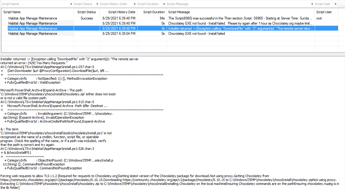

Thanks, however, there is still an issue with randomly launching the chocolatey installer so all the installs don't launch and all fail at the same time. Each system still shows attempting the install at the same time and then shows a failure. I have attached a screenshot showing this.
Below is part of the output from the script log:
Installer returned -> [Exception calling "DownloadFile" with "2" argument(s): "The remote server
returned an error: (429) Too Many Requests."
At C:\Windows\LTSvc\Habitat\AppManage\install.ps1:257 char:5
+ (Get-Downloader $url @ProxyConfiguration).DownloadFile($url, $fil ...
+ CategoryInfo : NotSpecified: (:) [], MethodInvocationException
+ FullyQualifiedErrorId : WebException
Microsoft.PowerShell.Archive\Expand-Archive : The path
'C:\Windows\TEMP\chocolatey\chocoInstall\chocolatey.zip' either does not exist
or is not a valid file system path.
At C:\Windows\LTSvc\Habitat\AppManage\install.ps1:515 char:5
+ Microsoft.PowerShell.Archive\Expand-Archive -Path $file -Destinat ...
+ CategoryInfo : InvalidArgument: (C:\Windows\TEMP...\chocolatey.
zip:String) [Expand-Archive], InvalidOperationException
+ FullyQualifiedErrorId : ArchiveCmdletPathNotFound,Expand-Archive
& : The term
'C:\Windows\TEMP\chocolatey\chocoInstall\tools\chocolateyInstall.ps1' is not
recognized as the name of a cmdlet, function, script file, or operable
program. Check the spelling of the name, or if a path was included, verify
that the path is correct and try again.
At C:\Windows\LTSvc\Habitat\AppManage\install.ps1:526 char:3
+ & $chocoInstallPS1
+ CategoryInfo : ObjectNotFound: (C:\Windows\TEMP...ateyInstall.p
s1:String) [], CommandNotFoundException
+ FullyQualifiedErrorId : CommandNotFoundException
Forcing web requests to allow TLS v1.2 (Required for requests to Chocolatey.org)
Getting latest version of the Chocolatey package for download.
Not using proxy.
Getting Chocolatey from https://community.chocolatey.org/api/v2 ... ey/0.10.15.
Downloading https://community.chocolatey.org/api/v2 ... ey/0.10.15 to C:\Windows\TEMP\chocolatey\chocoInstall\chocolatey.zip
Not using proxy.
Extracting C:\Windows\TEMP\chocolatey\chocoInstall\chocolatey.zip to C:\Windows\TEMP\chocolatey\chocoInstall
Installing Chocolatey on the local machine
Ensuring Chocolatey commands are on the path
Ensuring chocolatey.nupkg is in the lib folder]

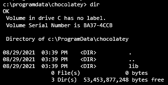

The issue with the applications being unable to upgrade due to too many requests is also still an issue. If I install Chocolatey manually instead of relying on the script, I can test the application installs. However, If I approve 10 applications and we have more than 10 systems, then nothing will update because of hitting the limit. Please see the output below.
Chocolatey v0.10.15
Upgrading the following packages:
gotomeeting
By upgrading you accept licenses for the packages.
gotomeeting is not installed. Installing...
gotomeeting not installed. An error occurred during installation:
The remote server returned an error: (429) Too Many Requests. Too Many Requests
gotomeeting package files upgrade completed. Performing other installation steps.
The upgrade of gotomeeting was NOT successful.
Chocolatey upgraded 0/1 packages. 1 packages failed.
See the log for details (C:\ProgramData\chocolatey\logs\chocolatey.log).
Failures
- gotomeeting (exited 1) - gotomeeting not installed. An error occurred during installation:
