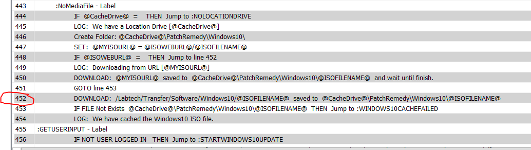

Odd,
We only download from one section of code.. Here is that code.
We first test for a ISO URL and if not exist we try the LT Share (see line 452)

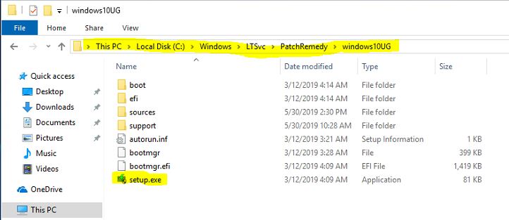

Re: Windows 10 ISO failed to download to the locations Network share.
Posted: Fri May 31, 2019 6:21 pm
Look in the ltsvc directory of agent for a patch remedy/windows10up/to see all extracted files from ISO. I bet ther ws some ssue with the extraction causing setup,exe not to be present.
Can you verify?

The created folder was windows10UG, not up. Don't know if that's a clue.

I issued the PR command to upgrade the OS now on this agent, and am currently at the point in the script where the last script log entry was:
"Windows 10 Updates are now processing on the PC, allow 2 to 4 hours to complete. User may need to log into system to fully complete the updates."
Task Manager, Details, shows a setup.exe running, consuming 532kb of Memory and zero CPU.
The Commands tile shows:
"cmd.exe!!! /c "%ltsvcdir%\PatchRemedy\windows10UG\setup.exe /auto upgrade /Compat IgnoreWarning /DynamicUpdate disable /copylogs c:\Windows10UpgradeLogs"
with an Output of 'OK'
NOW, while all of the above is going on (really, I don't believe anything at all is happening), I opened up an administrator-elevated CMD window on the agent itself, and ran the following command:
C:\Windows\LTSvc\PatchRemedy\windows10UG\setup.exe /?
That returned an error box titles 'Install Windows', showing the error message:
"The file 'autorun.dll' could not be loaded or is corrupt. Setup cannot continue. Error code is [0x7E]."
There is an autorun.dll located at C:\Windows\LTSvc\PatchRemedy\windows10UG\sources, and it shows it is 171kb.
I've run this script repeatedly and it keeps failing in the same way. It seems unlikely to me that the autorun.dll file might be bad within the .iso, but maybe?
