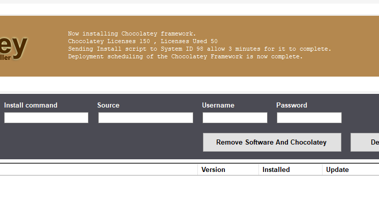

Installed the last version, but still the same:

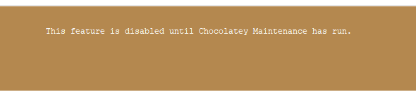

Disabled until Maintenance has run
Re: Disabled until Maintenance has run
- 2.png (16.4 KiB) Viewed 10216 times
- 1.png (2.24 KiB) Viewed 10216 times
Can you send us the script logs for agent 98? what was the different results to Choco install commands being run on agent during script run?

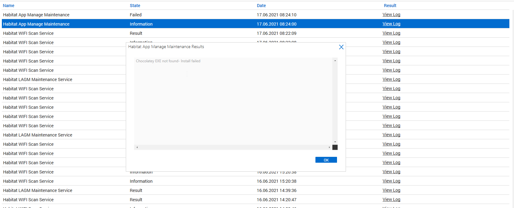

The script still says:; Chocolatey EXE not found- Install failed
And again we are banned on chcolatey.org
Habitat 3rd Party patching is disabeled, all shedules on chocolatey4labtech are on 24h hours.
In the script logs I can see, that Habitat still tries to install chocolatey. And I also see a lot of attempts of Habitat wifi service, but I do not see any option to disable Wifi scanning. I´m pretty sure, I disabled Wifi in the past, but now there is no config option in Habitat.
Is Habitat still working and causing this ban?
This is the same error we get just using the Chocolatey Plugin.mwilhelmi wrote: Thu Jun 17, 2021 6:37 am The script still says:; Chocolatey EXE not found- Install failed
Not much help I know but it's good to know we are not alone.
We are working through the different Chocolatey plugins to help resolve the lockouts.
Chocolatey for Labtech has not be modified yet as we are waiting to make sure we have Chocolatey for Automate working good. We then can move code base over to C4L and complete the family of updates to resolve some of these lockout issues.
