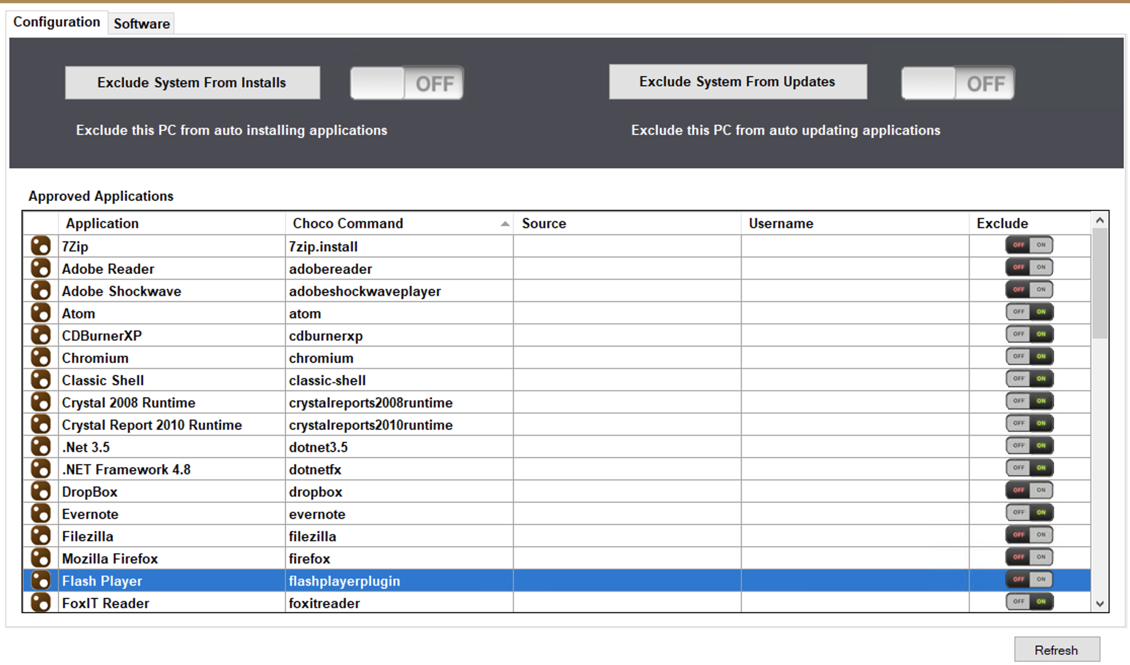

Maybe I'm not explaining this correctly.
So here is a screen shot of one of systems in question.
See where things like Atom, CDBurnerXP, Chromium are excluded from AutoInstall? Well what is happening is that if I enable Chocolatey the software that is listed as excluded is being installed anyway. So I can't enable Chocolatey installs at all or every single one of my managed computers gets every single one of these excluded applications.

Posts: 2704
9
Re: Framework not deploying with installs turned off.
Can you verify via agent script logs that the excluded applications are being passed to the agent for installs. There should be a record of each application that was pushed down.
This would help us isolate where this is happening for you.

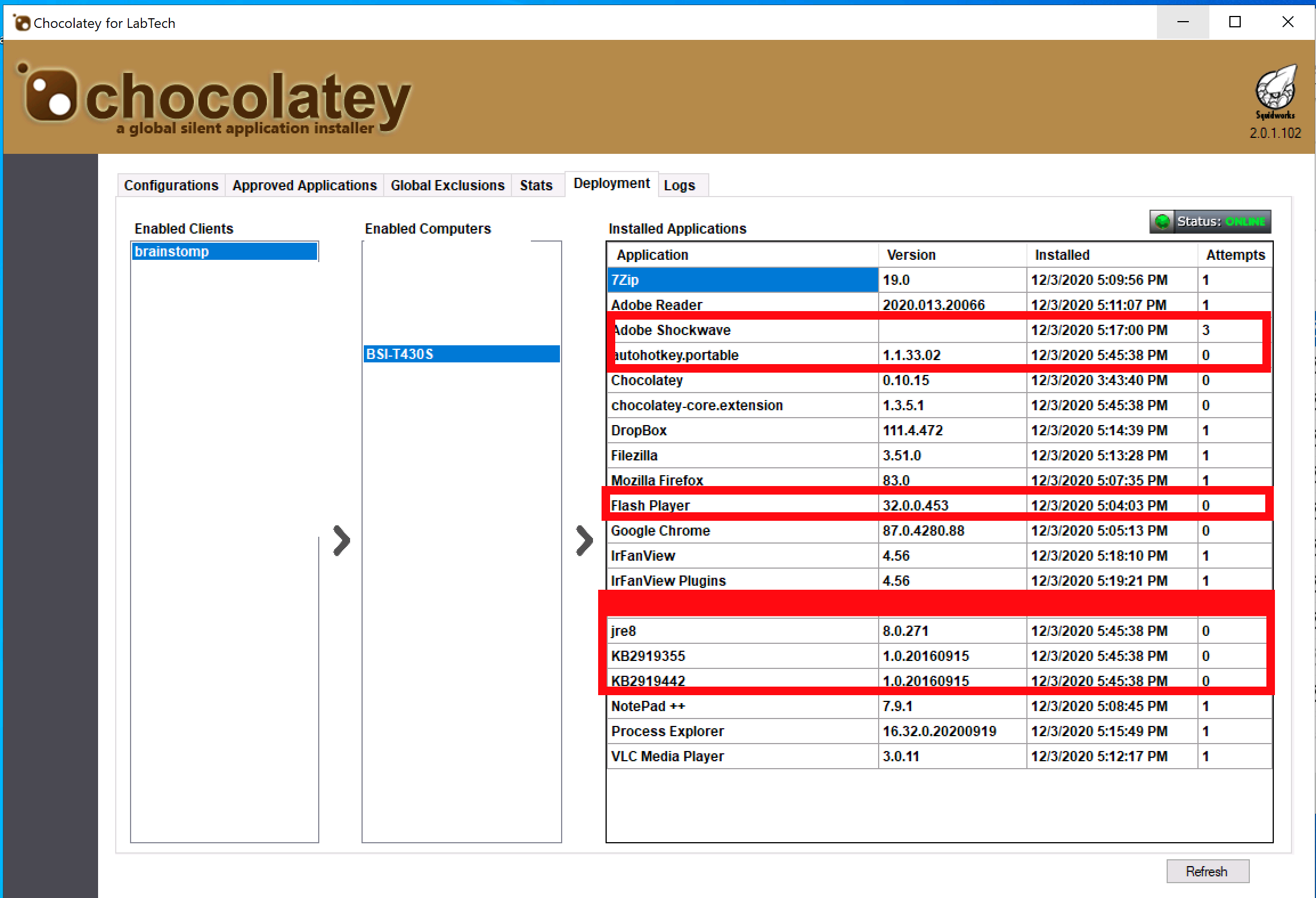

I built a system for testing this.
Here are the results so far.
Chocolatey Main Screen showing stuff deployed to test system. Everything in red was initially setup as No Auto Install
Screen Shot 2020-12-07 at 10.48.52.png (194.57 KiB) Viewed 5153 times

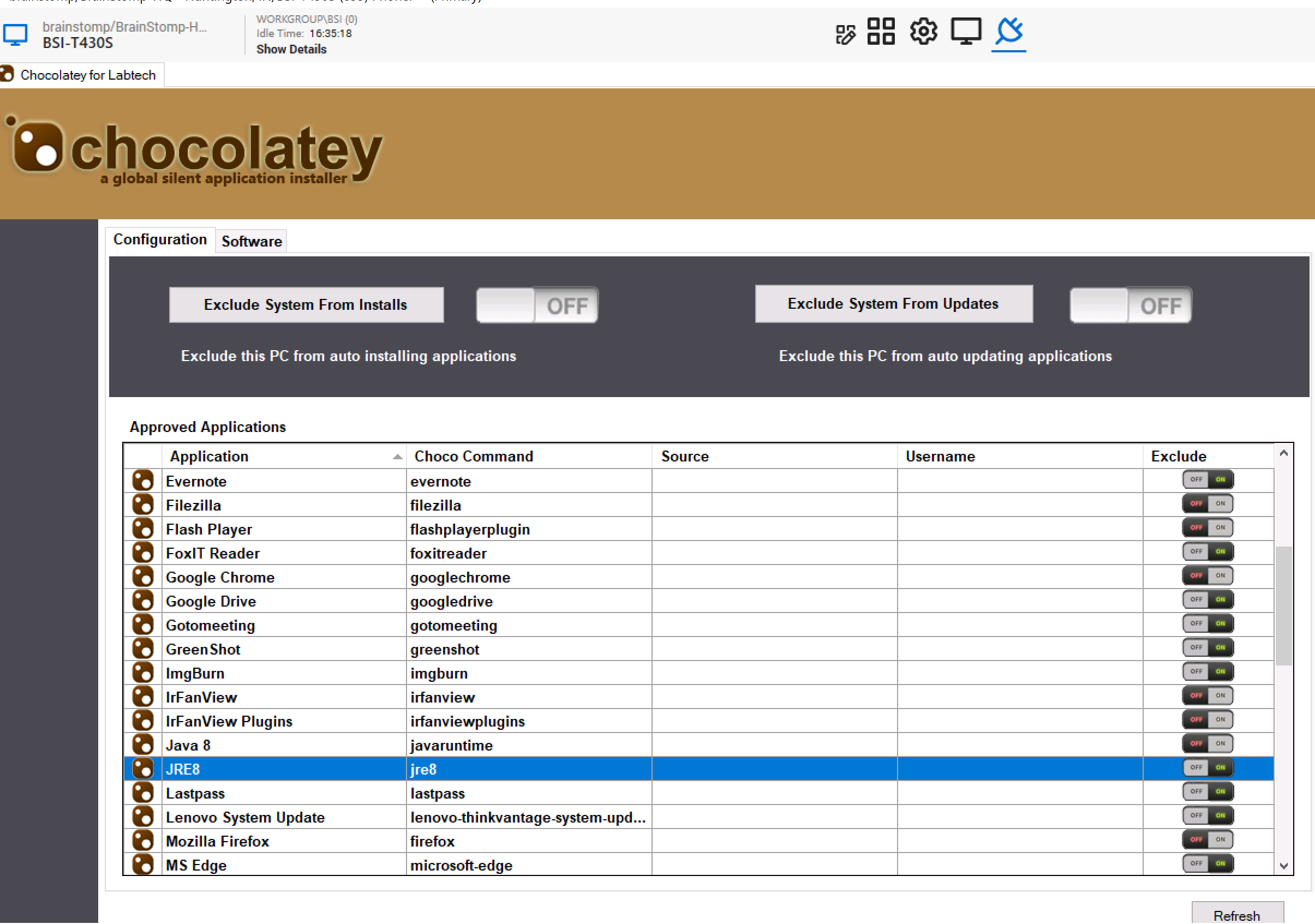

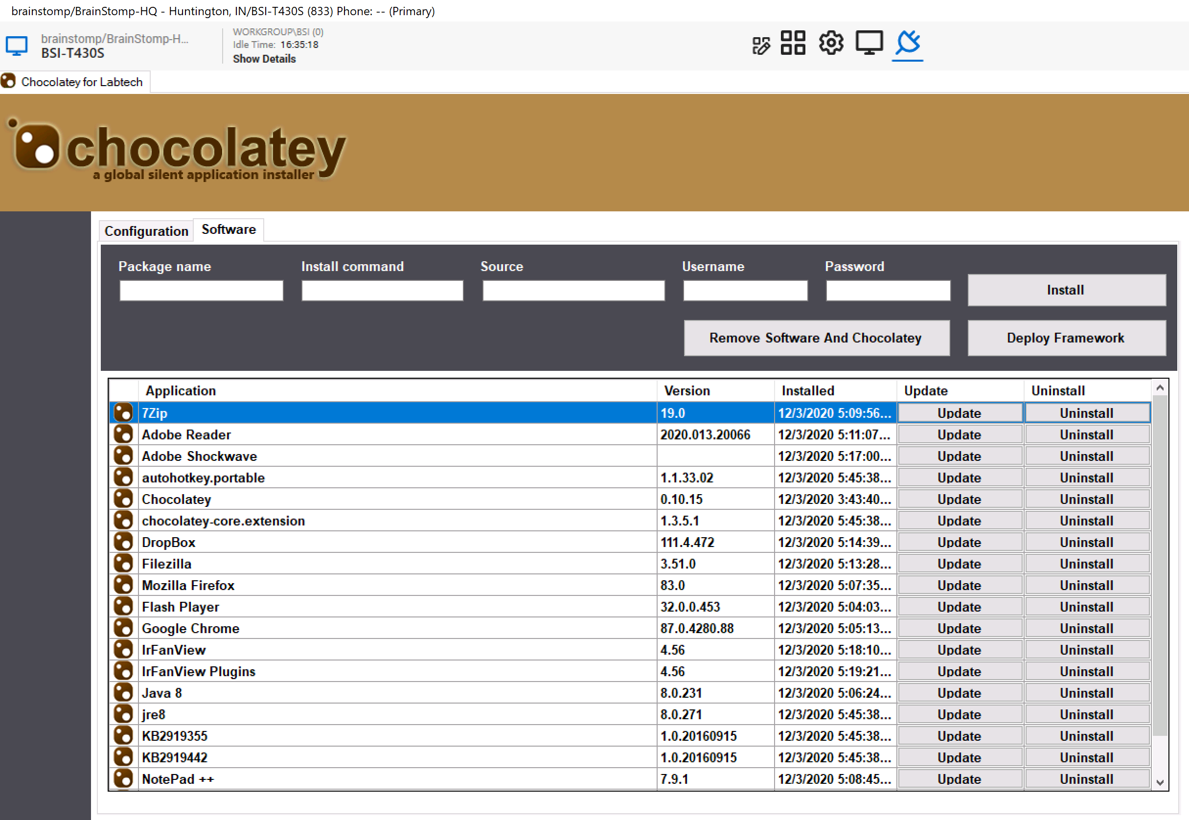

Test system Chocolatey plugin screen. See how there are applications installed that are not part of the auto install.
Screen Shot 2020-12-07 at 11.11.26.png (293.81 KiB) Viewed 5153 times
JRE8 is clearly excluded here even if Java8 is included. I know I setup all the Java stuff with no autoinstall. the KBs are also missing in this view even though they show installed in the other screen shot and they are not set to autoinstall either.
Screen Shot 2020-12-07 at 11.12.42.png (270.33 KiB) Viewed 5153 times
Posts: 2704
9
Brianstomp,
That was a big help! That put me right at the base of the problem, found the issue and resolved it in 2.0.1.103
We posted 2.0.1.103 up to the main site, set auto updater to push the new build starting tonight and if you want it just a bit quicker then the URL is
https://delivery.shopifyapps.com/-/39d4 ... d8b1c52f10
Let us know if you see any other odd behavior.
