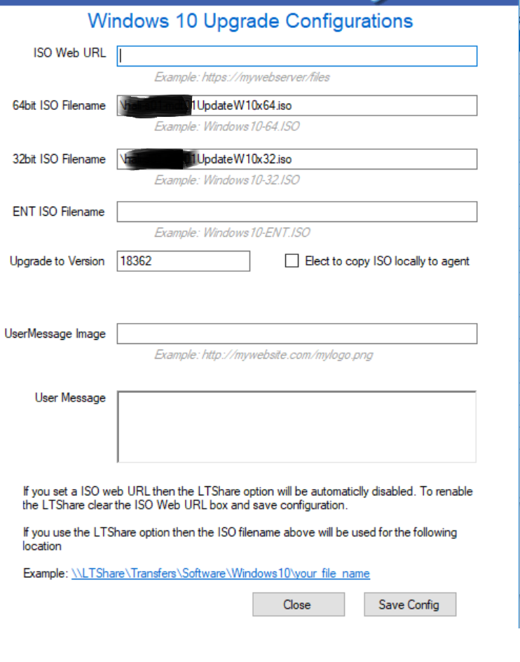

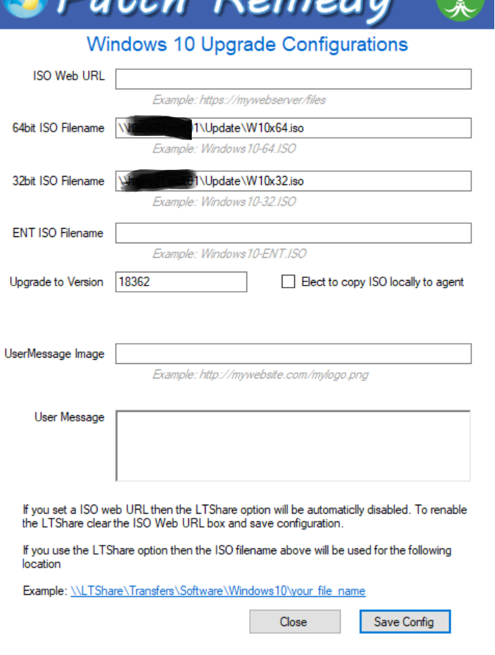

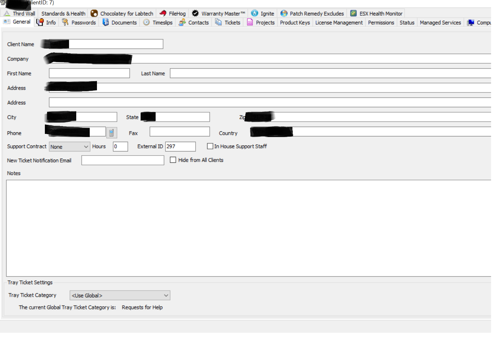

so the general tab, is missing the data server
and the config file, removes \ from my path, not sure why
im just trying to use this app to upgrade to the latest version of w10
please let me know what im doing wrong, as this is the first time i have used this app
config before save.png (198.14 KiB) Viewed 27993 times
config after save.png (168.4 KiB) Viewed 27993 times
general tab.png (158.45 KiB) Viewed 27993 times

Re: 1903 os update
Ok the first place I would start is here http://support.plugins4automate.com/vie ... 8e1b4e06e1
This will explain the basics.
Your configs are completely inaccurate so as it stands it will not function as configured. Read this document and see if it answers most of your questions, afterwards repost your issues and I can attempt to help.
