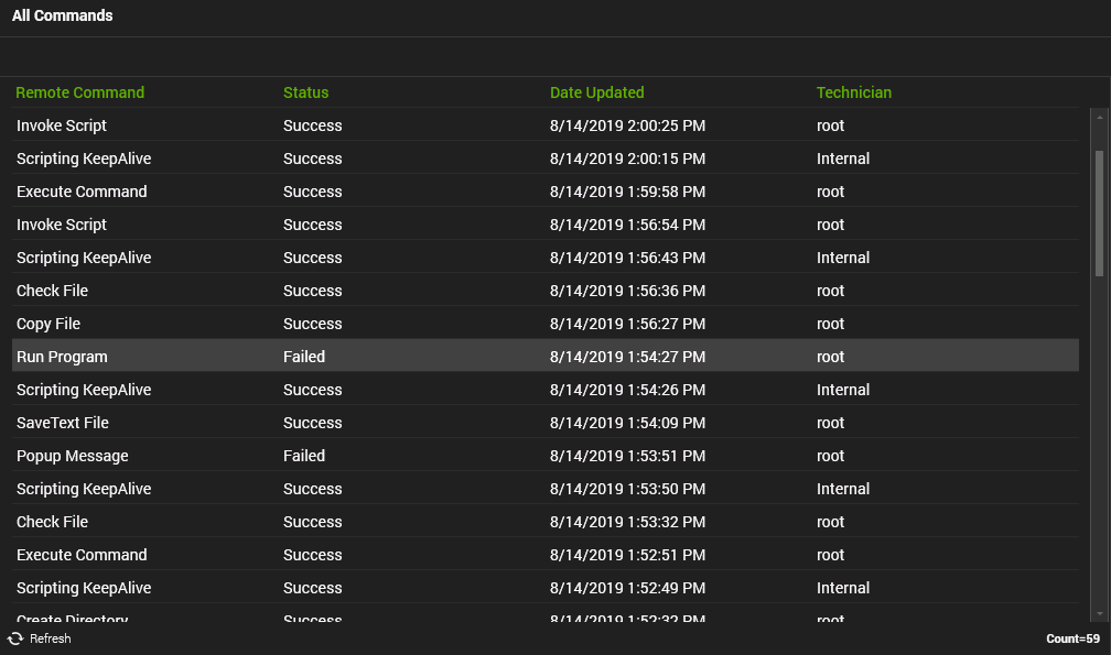

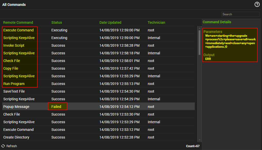

I have noticed recently that the Popup Message has been failing a-lot and even the HTA launch so the OS Build updates have been running in the background and restarting peoples computers without warning etc.
I have attached the LT logs showing it ... I checked the LT script and those lines are configured to exist on failure but it doesn't appear to be honoring that ?

Let me have a peek, I should be able to capture the ERR output and exit out if received. Lets see what I can do there.
