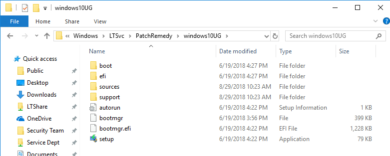

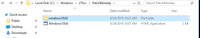

1. See attached for the file path C:\Windows\LTSvc\PatchRemedy Is this the correct path? Correct files downloaded?
2. See attached. Is this all the files needed?

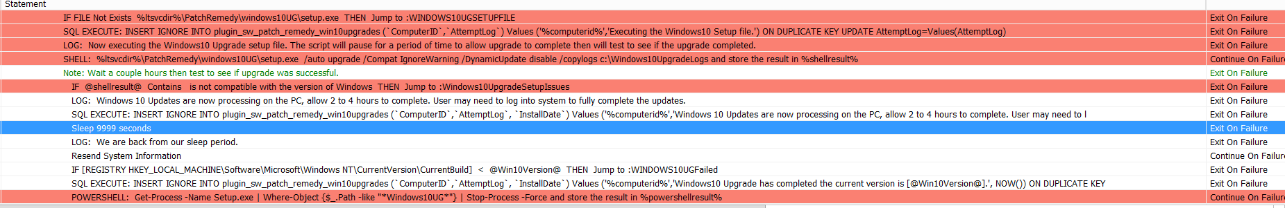

Would this be the correct command(s) in the script? See attached.

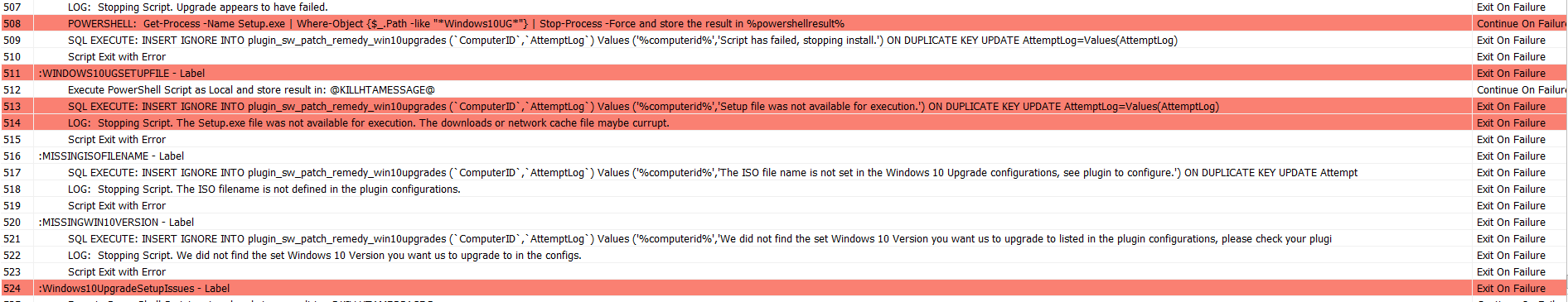

Also, line 507 is the message we get then line 510 message occurs as in last screenshot of my previous post.

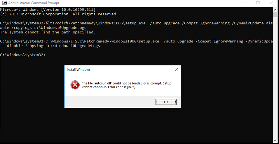

Ok tried to run the command as instructed. Here are the results.
C:\Windows\LTSvc\PatchRemedy\windows10UG\sources is where that .dll is found out.
Let me know if I incorrectly ran it. Or need additional information.
Re: Unsure what is going wrong
Yeap that was correct, the last command with full path...
And we got an error, The files that were extracted are corrupt. so lets step back a bit and test re-extracting the files from ISO.

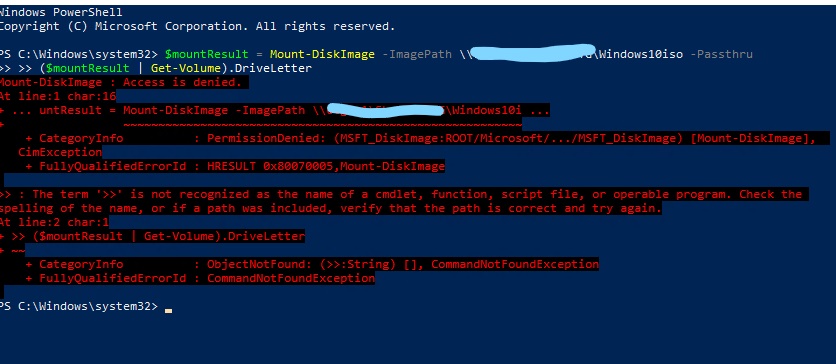

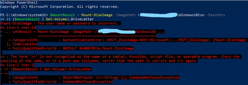

I tried running the first command on two machines. Here is the results.
Do i need the entire path of the iso including the .iso file or just the folder path where the iso is located? Please advise.
Nope your requesting it fine, the issue is your getting "Permission Denied" for the user executing the powershell console.
That is a typical issue that can be resolved by placing ISO on a basic open network share. Shares inside a domain environment must have permissions allowing a user and or the LT agent service user the ability to access files.
