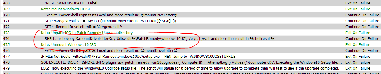

Here is a excerpt from our script showing what and where we are creating files.
As for the logs , that would be the ones. First off need to know what's in the error logs. Then we need to look at the time frames for the scheduled run and see what PR was doing during that time.

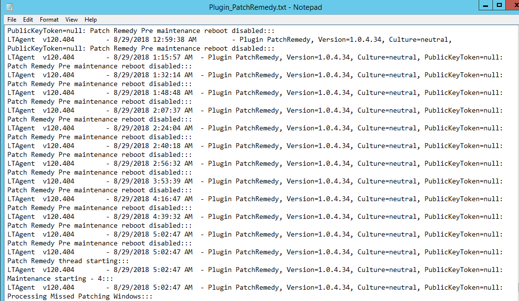

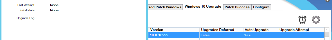

Stated before, I upgraded the iso to newest version. I ran another auto upgrade on a few machines for 8/29/18 at 1 am.
