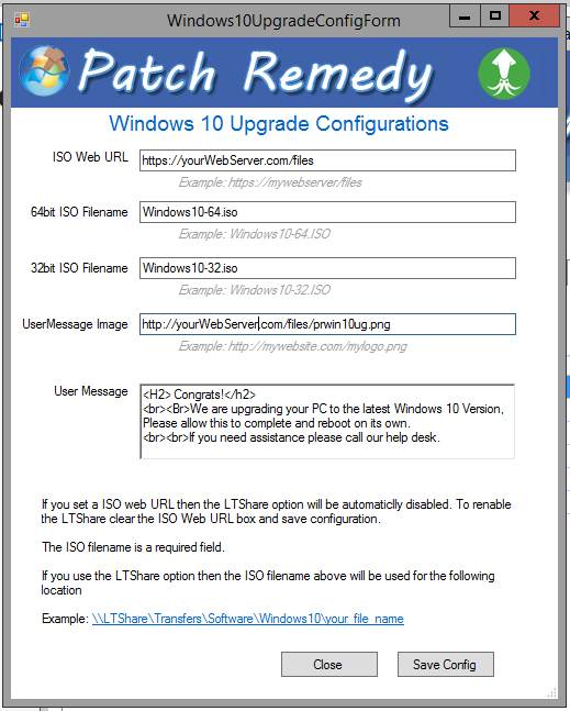

We first need to open Patch Remedy and go to the Windows 10 Upgrade tab. Find the GEAR in the right side of plugin and select it. That will launch the setup form where you will add all the configurations needed to support the upgrade process.
The configuration form needs to have the names of the 3 ISO files, 32 and 64 bit made from the media creation tool available from Microsoft and WIndows 10 Enterprise if you are going to upgrade Enterprise agents. You have 2 options for file transfers from CW Automate to the end agent. The default way will be to store the ISO files on the LTShare at \\LTShare\Transfers\Software\Windows10\. The second way is to place ISO files on the Internet at a web URL accessible from anywhere. If you supply a URL then you will disable the use of the LTShare in the plugin. The LTShare may not be accessible to all Clients and all Locations so URL is the preferred method to deliver the ISO files.
The User Message Image and User Message allows you to customize the splash screen the end user sees during upgrades "if" an active desktop is found during an upgrade attempt. You can supply a URL of a logo image and HTML encoded text to create a really nice splash screen for your end users. If nothing is supplied then we use the default Patch Remedy logo and a simple message directing them to helpdesk if any troubles.

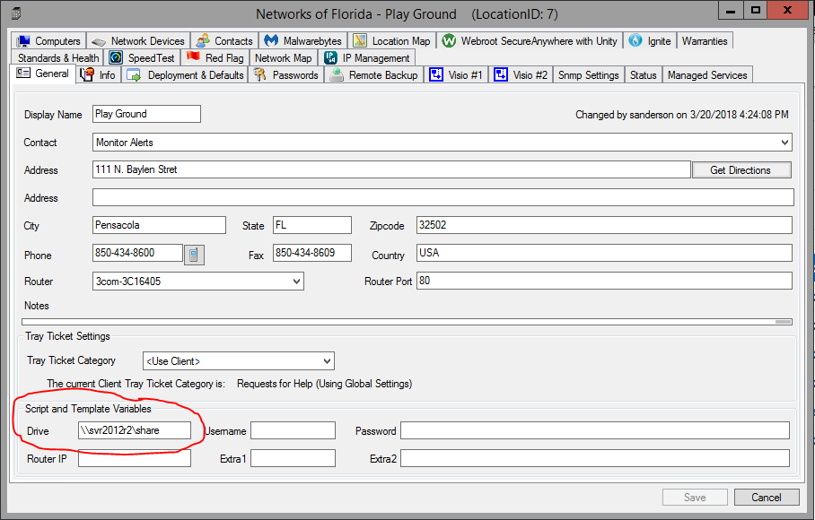

As explained above, Patch Remedy caches the ISO files so you do not flood the local networks of your clients with hundreds of ISO downloads from the agents being upgraded. For this process to work you will need to have the cache share configured for each "client location" you want to process upgrades at. If you supply a username and password in the provided fields then we will use those to attempt authentication of the NAS or remote share.

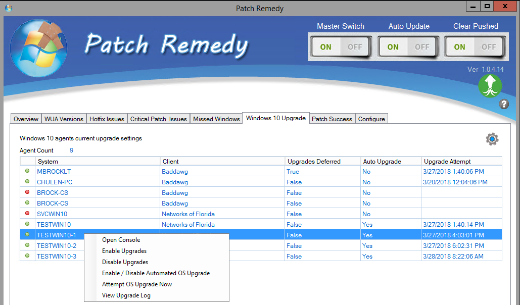

Once we have all our setups completed we are ready to start deploying Windows 10 upgrades. Select 1 or more agents from the list of Windows 10 agents and then right click mouse to reveal menu. There are 3 menu items for Upgrading Windows 10, Enable / Disable Automated OS Upgrade, Attempt OS Upgrade Now and View Upgrade Log.
To enable an OS upgrade on the next patch remedy cycle select to enable the upgrade from the menu. To start an upgrade now, select the attempt OS upgrade now menu item and to view the log entry for any agent in the process of or finished and upgrade process select the view upgrade logs.

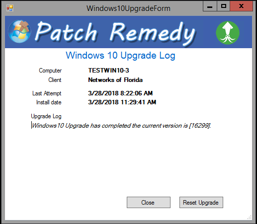

The agent upgrade log view shows the time of the attempted install and the verified completed date. it will also show you the current status of the logs. In this case we have successfully installed the upgrade to a 32 bit agent.
***If you are using the automation feature of the upgrade process and any attempt fails the automation will not retry that system until the Last Attempt time stamp is NULLed out. If at anytime a Last Attempt date can be viewed here Automation is disabled.*** Use the Reset Upgrade button to NULL out the Last Attempt Date if you want to allow agent to attempt another automated upgrade.

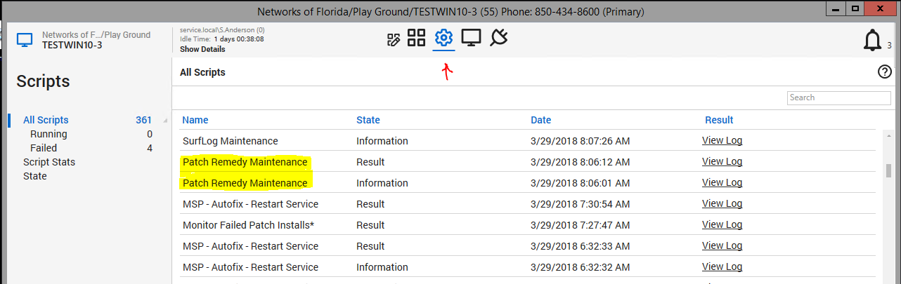

The process is script based. The Patch Remedy Maintenance script handles the upgrade process. Following the script logs on the agents console
The script can be monitored here for different statues. After the script gets to the final install point and executes the installer the script goes into a 4 hour sleep. This sleep allows the agent to reboot if needed and fully complete the upgrades before the script wakes backup and checks to see if the version is now showing up to date. The script will check the version and will log the results.

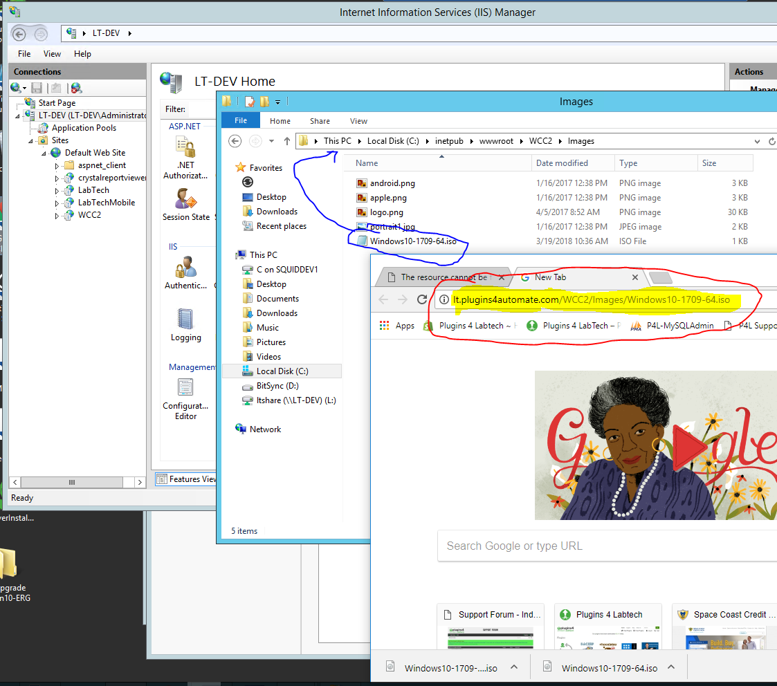

How To Setup a Hosted URL for your ISO files
You can self host your files on the Labtech server via a URL.
We placed our ISO image on the LT server at
C:\inetpub\wwwroot\WCC2\Images\myISO.iso
and can access it via URL
http://your.LTHOSTName.com/WCC2/Images/myISO.iso
So in the PR config the url would be http://your.LTHOSTName.com/WCC2/Images and your 64bit file would be named myISO.iso. We picked the image folder on the LT server as an example but based on your setups it can be any folder you want it to be in that is reachable via IIS's default website configurations.

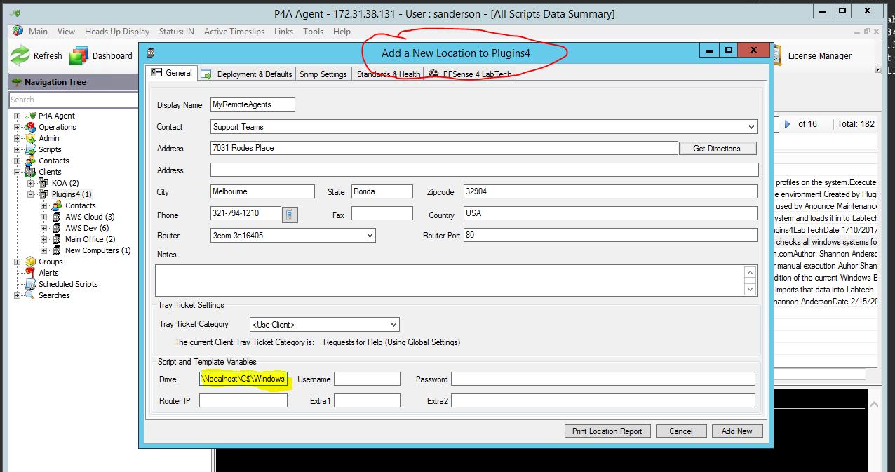

How to manager remote agents not able to access a network share
If you have remote desktops or laptops in the field that do not have access to the Location Drive then you will need to regroup these agents under a new location. Call your new client location RemoteAgents and set the Location Drive as so. Then move all remote agents to this new location. All agents in this location will now use the \\localhost\C$ admin share as the Location Drive. Of course agents will need the admin share active.
In the Location Drive box use
\\localhost\C$\Windows\LTSvc\PatchRemedy
This will cause the agent to download the ISO to the patch remedy working directory where it should then be unpacked and the installs can continue.
The end agents will need 10 GB of free drive space on C to complete the unpacking. (4.5 GB iso file and 5 GB unpacked install directory)

Hey Cubert. When I use \\localhost\C$\Windows\LTSvc as a drive at a roaming location, this is great. Those laptops out there are definitely downloading them to a local drive. I cannot, for the life of me, get it to work over a network share to \\server\sharename with a user/pass. Regular Patch Management works fine with it - plenty of patches in the share folders. But PatchRemedy OSUpgrade always tells me:
  • We have a Location Drive [\\server\share]
  • Downloading from URL [my url that definitely works]
  • The Windows 10 ISO failed to download to the network share [\\server\share\PatchRemedy\Windows10\]. Please debug failure and retry script.
What am I doing wrong, I'm pulling out my hair. It won't work even if I pre-download the .ISO to that folder \\server\share\PatchRemedy\Windows10\ - but pre-downloading the .ISO works fine if I put it in C:\Windows\LTSvc\PatchRemedy\Windows10\ and I'm using \\localhost\C$\Windows\LTSvc as a location drive

Thank you, Cubert. Any help on how to troubleshoot why PatchRemedy can't use a \\server\share with user/pass for us? PatchManager uses it without issue, so I'm just wondering if there is anything I can look at log wise, or enable log wise, to see why it won't use a UNC path with user/pass on the Location tab, with the exception of the \\localhost\c$\windows\LTSvc
Re: Patch Remedy 4 Windows10 Upgrade explained.
It wont use it because we haven't programed it to look there for creds. Its not that it cant do it, we have to tell it how and when to do it.
