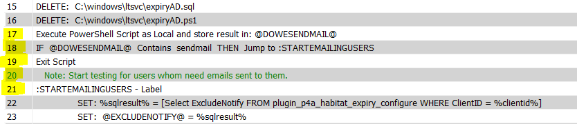

It can be yes,
We have this modification in our Habitat AD Password Notifier to resolve that very issue. Here is what you can do to resolve it in Expiry.
Edit the Expiry script located in the /scripts/maintenance/ script folder on your automate console.
Find line 16 and start adding new functions and notes as shown in image above.
We are basically breaking the script in half so that the AD scans run twice a day but the emails only run once (after 8 am). To do this we created a small powershell script that if current time is between 8 am and 4 pm it just echos "sendmail". we save that as an output to a variable and then test that variable to see if it contains "sendmail" if so we jump to :STARTEMAINGUSERS where we continue on doing the sending of email portion of script. If we get no return or not the "sendmail" we are expecting from POSH then we quitely quit the automate script.
Here is that powershell script
$min = Get-Date '8:00'
$max = Get-Date '16:00'
$now = Get-Date
if ($min.TimeOfDay -le $now.TimeOfDay -and $max.TimeOfDay -ge $now.TimeOfDay) {
  # send mail
   write-output "sendmail"
I hope this helps.

Hi Cubert, that worked fine. Thanks for the help.
