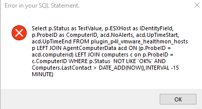

The Health Monitor Host Status keeps disabling itself (this was working fine when I first installed). I get the below error when running the SQL query.

The host health status monitor is 1 of 3 internal monitor setup when you elect to monitor the VMware plugin.
It uses a RAW SQL query to look for stale host check ins (ESX Hosts not responding to probes)
Here is that SQL query to run outside of monitor
Select p.Status as TestValue, p.ESXHost as IDentityField,  p.ProbeID as ComputerID, acd.NoAlerts, acd.UpTimeStart, acd.UpTimeEnd FROM plugin_p4l_vmware_healthmon_hosts p LEFT JOIN AgentComputerData acd ON (p.ProbeID = acd.computerid) LEFT JOIN computers c on p.ProbeID = c.ComputerID WHERE p.Status  NOT LIKE 'OK%'
Place this in SQL editor and run it. Does this produce that error you show above?
If not then look at RAW SQL for monitor and see if it matches what you see here. Is there any missing or added pieces of SQL?

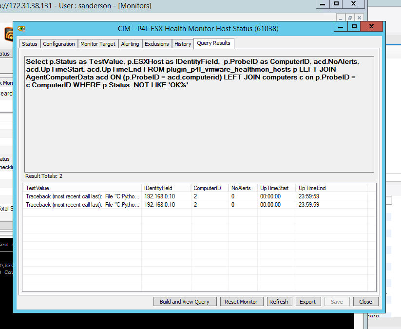

Now for issue number 2,
A grey symbol denotes a probe failure. mouse over icon for message to pop up with current error. What is that error?
Could be bad password for ESX Host
Could be bad username for ESX Host
Could be CIM service on ESXHost not responding
Could be ESX > 6.0 so CIM is administratively disabled on ESXHost and you will need to enable it.
Could be bad Probe install
so the error message will help you to answer which one it is.
Post error here and we can help decipher
